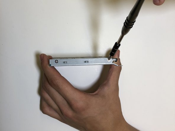

  5. Acer Aspire V3-551-8469 Hard Drive Replacement: crwdns2935265:05crwdnd2935265:01crwdnd2935265:02crwdne2935265:0 Acer Aspire V3-551-8469 Hard Drive Replacement: crwdns2935265:05crwdnd2935265:02crwdnd2935265:02crwdne2935265:0
    • Remove the four 5.3 mm screws that secure the hard drive in the frame.
