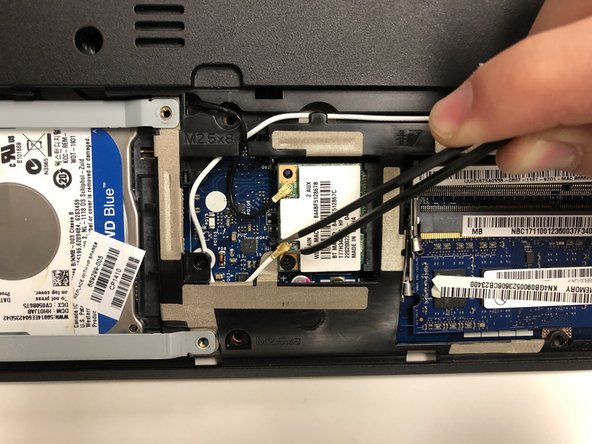

  3. Acer Aspire V3-551-8469 Fan Replacement: crwdns2935265:03crwdnd2935265:01crwdnd2935265:03crwdne2935265:0 Acer Aspire V3-551-8469 Fan Replacement: crwdns2935265:03crwdnd2935265:02crwdnd2935265:03crwdne2935265:0 Acer Aspire V3-551-8469 Fan Replacement: crwdns2935265:03crwdnd2935265:03crwdnd2935265:03crwdne2935265:0
    • Remove the back panel, and remove the white cable from the wifi chip using a pair of tweezers.

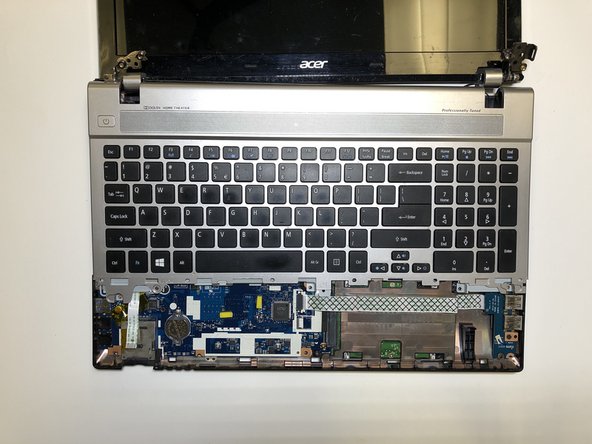

  5. Acer Aspire V3-551-8469 Fan Replacement: crwdns2935265:05crwdnd2935265:01crwdnd2935265:03crwdne2935265:0 Acer Aspire V3-551-8469 Fan Replacement: crwdns2935265:05crwdnd2935265:02crwdnd2935265:03crwdne2935265:0 Acer Aspire V3-551-8469 Fan Replacement: crwdns2935265:05crwdnd2935265:03crwdnd2935265:03crwdne2935265:0
    • Flip the computer over and remove the touchpad cover and keyboard.
    • Be careful doing this since there are two ribbon cables connecting both panels to the motherboard.

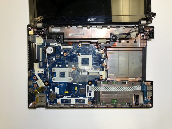

  6. Acer Aspire V3-551-8469 Fan Replacement: crwdns2935265:06crwdnd2935265:01crwdnd2935265:02crwdne2935265:0 Acer Aspire V3-551-8469 Fan Replacement: crwdns2935265:06crwdnd2935265:02crwdnd2935265:02crwdne2935265:0
    • Disconnect the four ribbon cables.
  7. Acer Aspire V3-551-8469 Fan Replacement: crwdns2935265:07crwdnd2935265:01crwdnd2935265:01crwdne2935265:0
    • Remove the five 5.3 mm Phillips #0 screws.
  8. Acer Aspire V3-551-8469 Fan Replacement: crwdns2935265:08crwdnd2935265:01crwdnd2935265:01crwdne2935265:0
    • Gently lift up the motherboard and slide it out to the right.
    • Do not force the board. If stuck, check that the ports on the left are loose, that no wires are still attached, and no screws are still in.

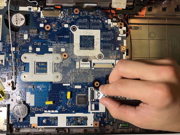

  9. Acer Aspire V3-551-8469 Fan Replacement: crwdns2935265:09crwdnd2935265:01crwdnd2935265:01crwdne2935265:0
    • Flip the motherboard over and using a pair of tweezers, remove the cable.

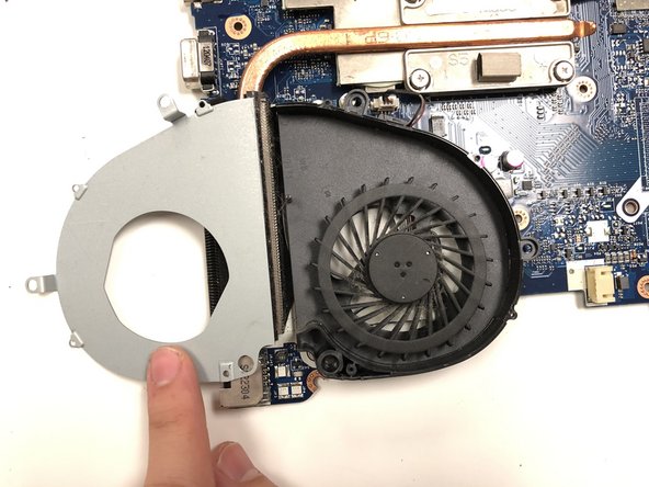

  10. Acer Aspire V3-551-8469 Fan Replacement: crwdns2935265:010crwdnd2935265:01crwdnd2935265:02crwdne2935265:0 Acer Aspire V3-551-8469 Fan Replacement: crwdns2935265:010crwdnd2935265:02crwdnd2935265:02crwdne2935265:0
    • Remove the six 2mm Phillips #00 screws.
  11. Acer Aspire V3-551-8469 Fan Replacement: crwdns2935265:011crwdnd2935265:01crwdnd2935265:01crwdne2935265:0
    • Using a pair of tweezers, remove the cable.
