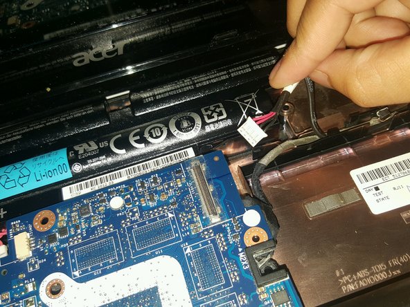

  6. Acer Aspire TimelineX 4830T-6682 Power Plug  Replacement Replacement, Power Plug: crwdns2935265:06crwdnd2935265:01crwdnd2935265:01crwdne2935265:0
    • The power connector is easy to spot once you have removed the keyboard.
  7. Acer Aspire TimelineX 4830T-6682 Power Plug  Replacement Replacement: crwdns2935265:07crwdnd2935265:01crwdnd2935265:01crwdne2935265:0
    • Slide the DVD drive out of the computer to gain access to the cables
  8. Acer Aspire TimelineX 4830T-6682 Power Plug  Replacement Replacement: crwdns2935265:08crwdnd2935265:01crwdnd2935265:02crwdne2935265:0 Acer Aspire TimelineX 4830T-6682 Power Plug  Replacement Replacement: crwdns2935265:08crwdnd2935265:02crwdnd2935265:02crwdne2935265:0
    • The rubber block is attached with a mild adhesive. Use the spudger tool to loosen it
    • Once the block is loose, use the spudger to unhook the wires from their guides.
  9. Acer Aspire TimelineX 4830T-6682 Power Plug  Replacement Replacement: crwdns2935265:09crwdnd2935265:01crwdnd2935265:02crwdne2935265:0 Acer Aspire TimelineX 4830T-6682 Power Plug  Replacement Replacement: crwdns2935265:09crwdnd2935265:02crwdnd2935265:02crwdne2935265:0

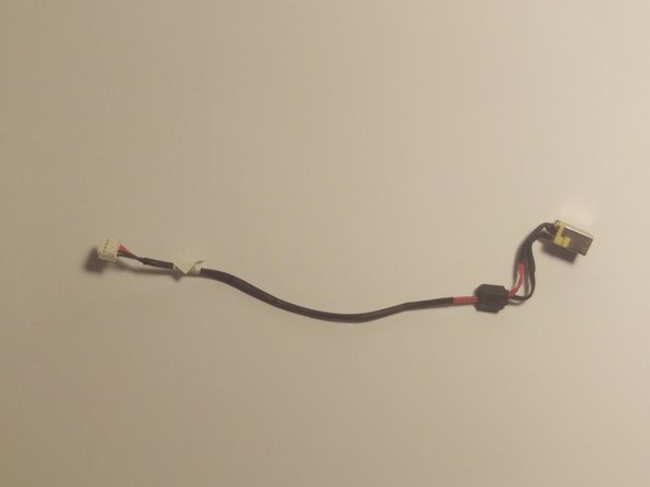

    • The body of the plug is glued to the computer. Use the spudger tool to wiggle the plug until it comes loose.
  10. Acer Aspire TimelineX 4830T-6682 Power Plug  Replacement Replacement: crwdns2935265:010crwdnd2935265:01crwdnd2935265:03crwdne2935265:0 Acer Aspire TimelineX 4830T-6682 Power Plug  Replacement Replacement: crwdns2935265:010crwdnd2935265:02crwdnd2935265:03crwdne2935265:0 Acer Aspire TimelineX 4830T-6682 Power Plug  Replacement Replacement: crwdns2935265:010crwdnd2935265:03crwdnd2935265:03crwdne2935265:0
    • Use gentle pressure to pull the plug from its socket on the motherboard. Once the plug is loose, you can pull the entire plug assembly from the computer.
