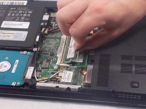

  5. Acer Aspire TimelineX 4820T-6645 RAM Replacement: crwdns2935265:05crwdnd2935265:01crwdnd2935265:03crwdne2935265:0 Acer Aspire TimelineX 4820T-6645 RAM Replacement: crwdns2935265:05crwdnd2935265:02crwdnd2935265:03crwdne2935265:0 Acer Aspire TimelineX 4820T-6645 RAM Replacement: crwdns2935265:05crwdnd2935265:03crwdnd2935265:03crwdne2935265:0
    • On either side of the RAM module, there will be two metal tabs. Slide both tabs away from the memory module and the RAM module will pop loose.
    • The location of the tabs are shown by two red circles. Once these tabs are pulled to the side the RAM will pop up. Pulling straight back on the module will remove it.
    • Be careful, these metal tabs may break if you apply too much force to them.
