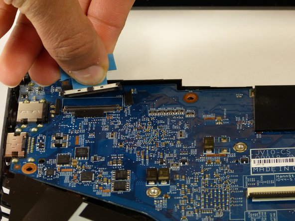

    • Remove the motherboard from the base of the laptop by unscrew the screw drivers using PH0 mm Phillips Head.
    • Carefully remove the charger attachment in the top left.

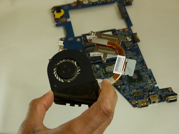

  7. Acer Aspire TimelineX 1830T-68U118 Fan Replacement: crwdns2935265:07crwdnd2935265:01crwdnd2935265:03crwdne2935265:0 Acer Aspire TimelineX 1830T-68U118 Fan Replacement: crwdns2935265:07crwdnd2935265:02crwdnd2935265:03crwdne2935265:0 Acer Aspire TimelineX 1830T-68U118 Fan Replacement: crwdns2935265:07crwdnd2935265:03crwdnd2935265:03crwdne2935265:0
    • Carefully remove the fan from the motherboard by detaching the plastic insert as seen in the pictures
