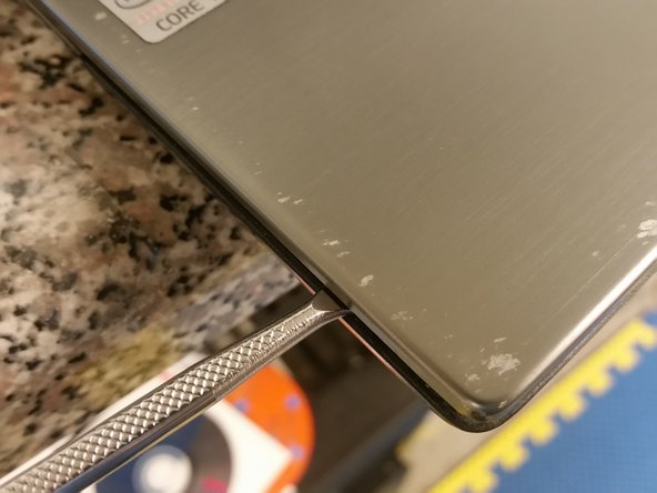

    • Open the lid othe the netbook. Use the Jimmy from the upper left corner of the keyboard. Put it between the keyboard and th casing and move it to the right. It might help to use a metal spudger to push in the pins holding the keyboard in place.
    • Then move down along the sides where there is one pin on each side. After that twist the keyboard towards you.

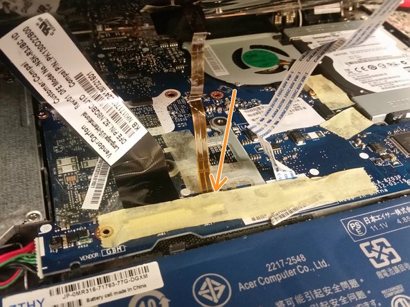

  8. Acer Aspire TimelineU M5-581T-6807 Hard Drive Replacement, Remove palmrest: crwdns2935265:08crwdnd2935265:01crwdnd2935265:03crwdne2935265:0 Acer Aspire TimelineU M5-581T-6807 Hard Drive Replacement, Remove palmrest: crwdns2935265:08crwdnd2935265:02crwdnd2935265:03crwdne2935265:0 Acer Aspire TimelineU M5-581T-6807 Hard Drive Replacement, Remove palmrest: crwdns2935265:08crwdnd2935265:03crwdnd2935265:03crwdne2935265:0
    • Remove the 12 screws securing the palmrest.
    • Slowly lift the palmrest up at the front, and stop when you feel the cable slack run out.
    • Remove the tape covering the connectors.
  9. Acer Aspire TimelineU M5-581T-6807 Hard Drive Replacement, Remove palmrest cables from connectors: crwdns2935265:09crwdnd2935265:01crwdnd2935265:01crwdne2935265:0
    • Unlock the three connectors, and remove their cables.
    • Continue to lift the palmrest upwards in the front, to the point that it hinges over onto the laptop screen, so as not to pull on the remaining cable on the palmrest. You don't need to disconnect this one.
