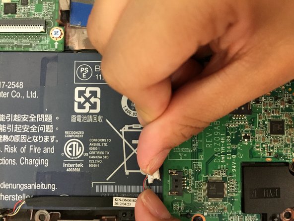

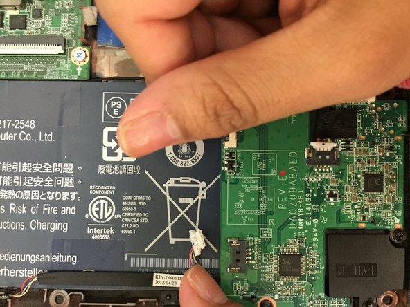

    • Gently disconnect the six bundled cables (red, black, and green) attached to both the battery and motherboard by pinching them with your thumb and forefinger. Pull with moderate force towards the left to disconnect.
