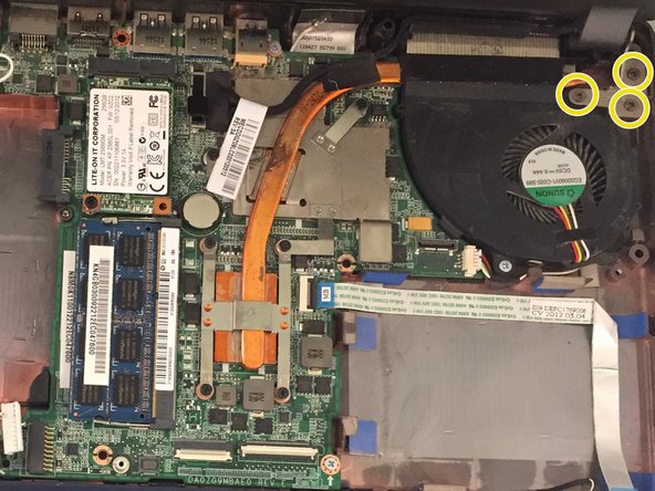

    • Use the #J1 Phillips head screwdriver to unscrew six #J1 Phillips head screws but do not remove the screws.
    • Do careful to not remove the screws until the entire fan is taken out.

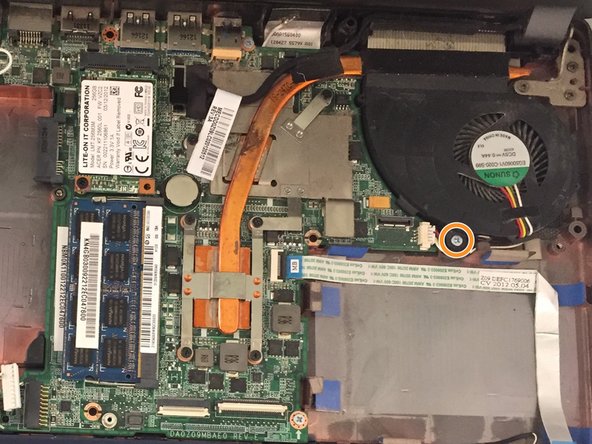

    • Use the #J1 Phillips head screwdriver to unscrew one 5mm #J1 Phillips head screw from the side of the fan closest to you.
    • Use the #J1 Phillips head screwdriver to unscrew three 7 mm #J1 screws from the top corner of fan.

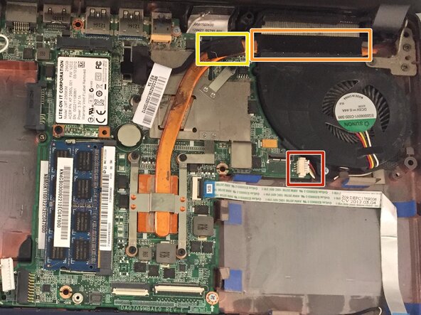

    • Using your fingernails and the metal spudger's pointed end, push the white cable connector away from the port.
    • Using your fingernails, take the tape off of the top of the fan.
    • Using your fingernails, take the tape off the side of the fan.
