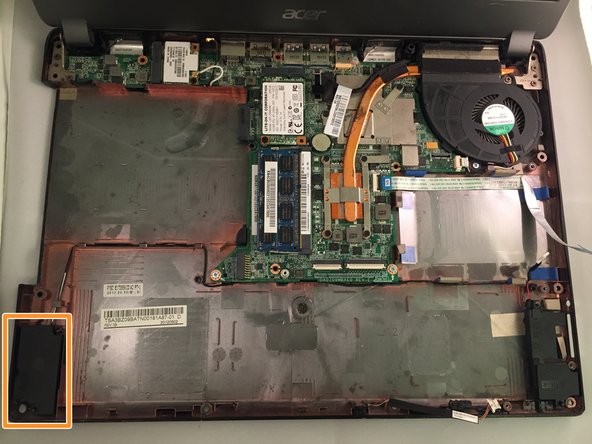

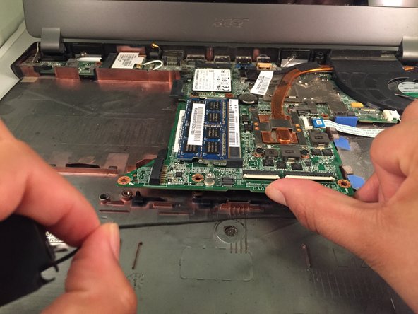

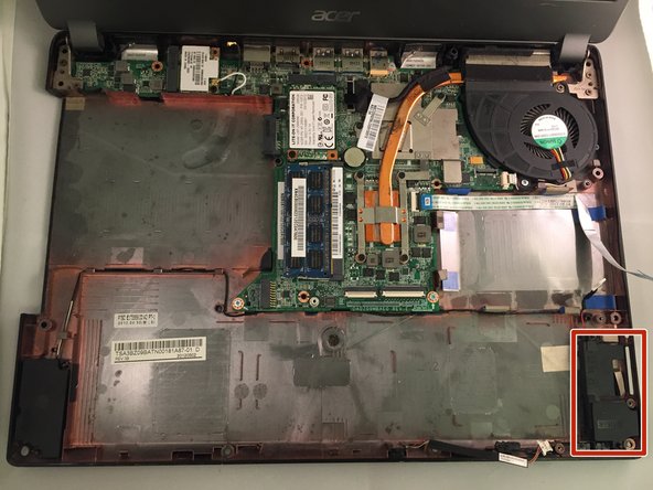

  14. Acer Aspire TimelineU M5-481TG Audio Drive Replacement, Audio Drive: crwdns2935265:014crwdnd2935265:01crwdnd2935265:02crwdne2935265:0 Acer Aspire TimelineU M5-481TG Audio Drive Replacement, Audio Drive: crwdns2935265:014crwdnd2935265:02crwdnd2935265:02crwdne2935265:0
    • Use the #J1 Phillips Head screwdriver to unscrew three 4 mm #J1 screws from the side of the motherboard closest to you.
    • Pick up the audio drive from bottom left corner of computer.
  15. Acer Aspire TimelineU M5-481TG Audio Drive Replacement: crwdns2935265:015crwdnd2935265:01crwdnd2935265:03crwdne2935265:0 Acer Aspire TimelineU M5-481TG Audio Drive Replacement: crwdns2935265:015crwdnd2935265:02crwdnd2935265:03crwdne2935265:0 Acer Aspire TimelineU M5-481TG Audio Drive Replacement: crwdns2935265:015crwdnd2935265:03crwdnd2935265:03crwdne2935265:0
    • Lift motherboard and gently pull audio drive wire towards you until the wire is free.
    • Lift speaker at bottom right of computer to remove the audio drive.
