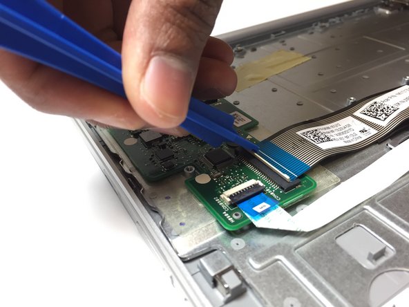

  3. Acer Aspire Switch 10 SW5-012-18MY USB Port Replacement: crwdns2935265:03crwdnd2935265:01crwdnd2935265:03crwdne2935265:0 Acer Aspire Switch 10 SW5-012-18MY USB Port Replacement: crwdns2935265:03crwdnd2935265:02crwdnd2935265:03crwdne2935265:0 Acer Aspire Switch 10 SW5-012-18MY USB Port Replacement: crwdns2935265:03crwdnd2935265:03crwdnd2935265:03crwdne2935265:0
    • Flip up the ZIF connector that holds the larger ribbon cable in place with the opening tool.
    • Carefully unplug the larger ribbon cable by pulling on its blue tab.

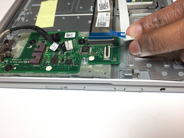

  4. Acer Aspire Switch 10 SW5-012-18MY USB Port Replacement: crwdns2935265:04crwdnd2935265:01crwdnd2935265:03crwdne2935265:0 Acer Aspire Switch 10 SW5-012-18MY USB Port Replacement: crwdns2935265:04crwdnd2935265:02crwdnd2935265:03crwdne2935265:0 Acer Aspire Switch 10 SW5-012-18MY USB Port Replacement: crwdns2935265:04crwdnd2935265:03crwdnd2935265:03crwdne2935265:0
    • Flip up the small ZIF connector that holds the smaller ribbon cable in place with the opening tool.
    • Carefully unplug the smaller ribbon cable by pulling on its blue tab.

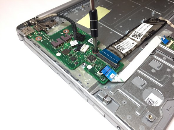

  5. Acer Aspire Switch 10 SW5-012-18MY USB Port Replacement: crwdns2935265:05crwdnd2935265:01crwdnd2935265:03crwdne2935265:0 Acer Aspire Switch 10 SW5-012-18MY USB Port Replacement: crwdns2935265:05crwdnd2935265:02crwdnd2935265:03crwdne2935265:0 Acer Aspire Switch 10 SW5-012-18MY USB Port Replacement: crwdns2935265:05crwdnd2935265:03crwdnd2935265:03crwdne2935265:0
    • Remove the 3, 2.5 mm screws on the circuit board.

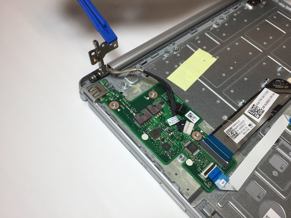

  7. Acer Aspire Switch 10 SW5-012-18MY USB Port Replacement: crwdns2935265:07crwdnd2935265:01crwdnd2935265:03crwdne2935265:0 Acer Aspire Switch 10 SW5-012-18MY USB Port Replacement: crwdns2935265:07crwdnd2935265:02crwdnd2935265:03crwdne2935265:0 Acer Aspire Switch 10 SW5-012-18MY USB Port Replacement: crwdns2935265:07crwdnd2935265:03crwdnd2935265:03crwdne2935265:0
    • Lift the security tab so that it will be out of the way when you remove the circuit board.
    • Using your fingers may be easier than using the opening tool for this particular step, although both can be used.

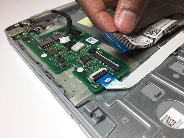

  8. Acer Aspire Switch 10 SW5-012-18MY USB Port Replacement: crwdns2935265:08crwdnd2935265:01crwdnd2935265:03crwdne2935265:0 Acer Aspire Switch 10 SW5-012-18MY USB Port Replacement: crwdns2935265:08crwdnd2935265:02crwdnd2935265:03crwdne2935265:0 Acer Aspire Switch 10 SW5-012-18MY USB Port Replacement: crwdns2935265:08crwdnd2935265:03crwdnd2935265:03crwdne2935265:0
    • Remove the circuit board by lifting it up with the opening tool.
    • The USB port is attached to this circuit board you have just removed. To replace the USB port on this piece, please go to the page How To Solder and Desolder Connections.
