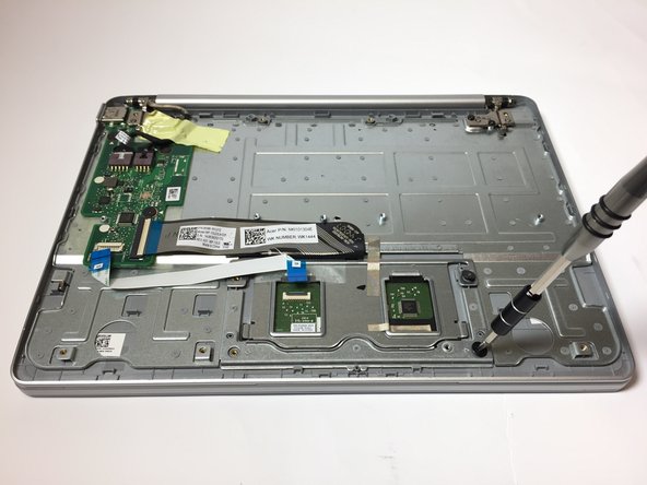

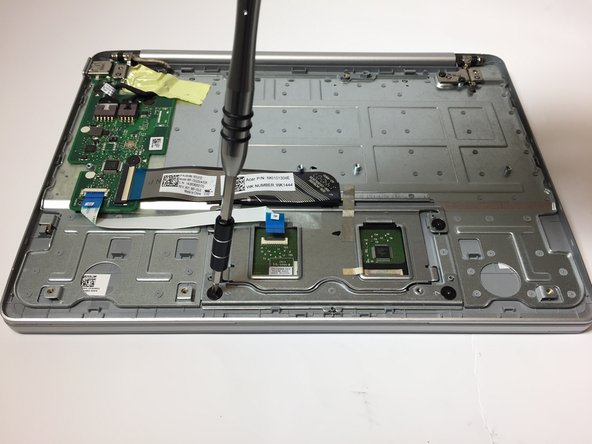

  3. Acer Aspire Switch 10 SW5-012-18MY Trackpad Replacement: crwdns2935265:03crwdnd2935265:01crwdnd2935265:03crwdne2935265:0 Acer Aspire Switch 10 SW5-012-18MY Trackpad Replacement: crwdns2935265:03crwdnd2935265:02crwdnd2935265:03crwdne2935265:0 Acer Aspire Switch 10 SW5-012-18MY Trackpad Replacement: crwdns2935265:03crwdnd2935265:03crwdnd2935265:03crwdne2935265:0
    • Remove the 4, 2.5 mm screws from the trackpad cover.
  4. Acer Aspire Switch 10 SW5-012-18MY Trackpad Replacement: crwdns2935265:04crwdnd2935265:01crwdnd2935265:02crwdne2935265:0 Acer Aspire Switch 10 SW5-012-18MY Trackpad Replacement: crwdns2935265:04crwdnd2935265:02crwdnd2935265:02crwdne2935265:0
    • Remove the metal piece that secures the trackpad cover in place using the opening tool.
  5. Acer Aspire Switch 10 SW5-012-18MY Trackpad Replacement: crwdns2935265:05crwdnd2935265:01crwdnd2935265:03crwdne2935265:0 Acer Aspire Switch 10 SW5-012-18MY Trackpad Replacement: crwdns2935265:05crwdnd2935265:02crwdnd2935265:03crwdne2935265:0 Acer Aspire Switch 10 SW5-012-18MY Trackpad Replacement: crwdns2935265:05crwdnd2935265:03crwdnd2935265:03crwdne2935265:0
    • Remove the trackpad using the opening tool and your hands.
