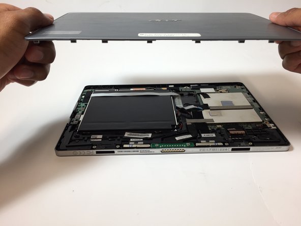

  3. Acer Aspire Switch 10 SW5-012-18MY Power Light Replacement: crwdns2935265:03crwdnd2935265:01crwdnd2935265:02crwdne2935265:0 Acer Aspire Switch 10 SW5-012-18MY Power Light Replacement: crwdns2935265:03crwdnd2935265:02crwdnd2935265:02crwdne2935265:0
    • Lift the back cover off of the device with your hands.
    • You will need to use some force to pull off the back cover.

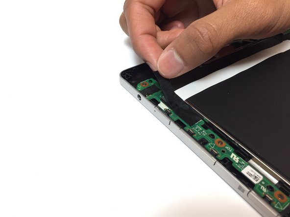

  4. Acer Aspire Switch 10 SW5-012-18MY Power Light Replacement: crwdns2935265:04crwdnd2935265:01crwdnd2935265:02crwdne2935265:0 Acer Aspire Switch 10 SW5-012-18MY Power Light Replacement: crwdns2935265:04crwdnd2935265:02crwdnd2935265:02crwdne2935265:0
    • Remove the piece of black, thin tape that is attached to the circuit board closest to the power button.

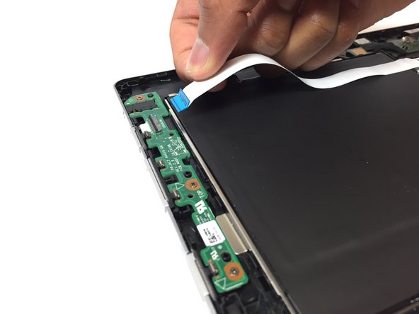

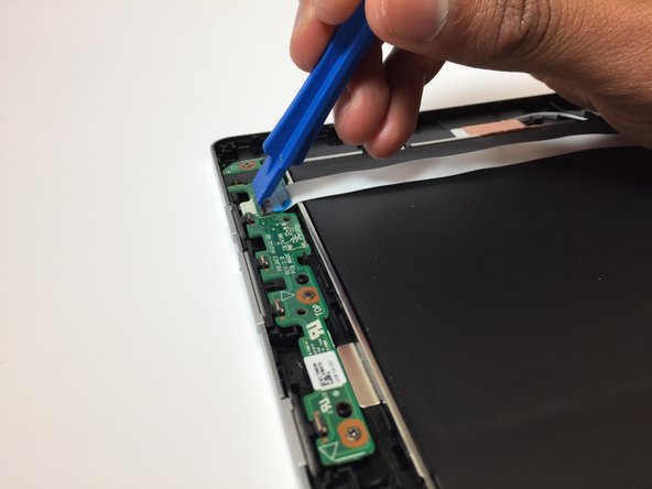

  5. Acer Aspire Switch 10 SW5-012-18MY Power Light Replacement: crwdns2935265:05crwdnd2935265:01crwdnd2935265:03crwdne2935265:0 Acer Aspire Switch 10 SW5-012-18MY Power Light Replacement: crwdns2935265:05crwdnd2935265:02crwdnd2935265:03crwdne2935265:0 Acer Aspire Switch 10 SW5-012-18MY Power Light Replacement: crwdns2935265:05crwdnd2935265:03crwdnd2935265:03crwdne2935265:0
    • Use the opening tool to lift the black ZIF connector holding the ribbon cable in place.
    • Pull out the ribbon cable from the circuit board. This cable should have the word "Audio" on it.

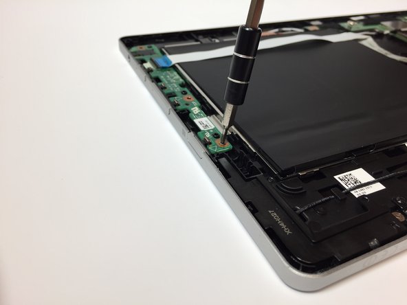

  6. Acer Aspire Switch 10 SW5-012-18MY Power Light Replacement: crwdns2935265:06crwdnd2935265:01crwdnd2935265:03crwdne2935265:0 Acer Aspire Switch 10 SW5-012-18MY Power Light Replacement: crwdns2935265:06crwdnd2935265:02crwdnd2935265:03crwdne2935265:0 Acer Aspire Switch 10 SW5-012-18MY Power Light Replacement: crwdns2935265:06crwdnd2935265:03crwdnd2935265:03crwdne2935265:0
    • Use the screwdriver to remove the 3, 3 mm screws on the circuit board.

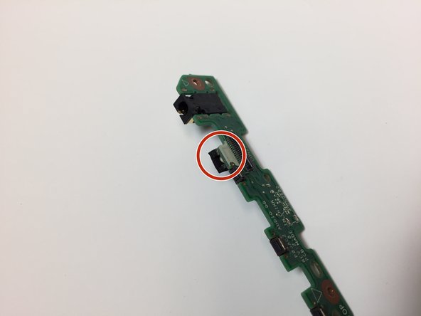

    • Carefully remove the circuit board from the device. The power light is located on this board.
    • The power light is attached to this circuit board you have just removed. To replace the power light on this piece, please go to the page How To Solder and Desolder Connections.
