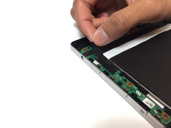

    • Remove the piece of black, thin tape that is attached to the circuit board closest to the power button.

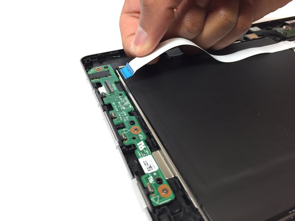

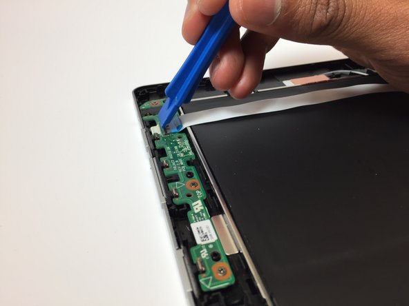

    • Use the opening tool to lift the ZIF connector that is holding the ribbon cable in place.
    • Pull out the ribbon cable from the circuit board. This cable should have the word "Audio" on it.

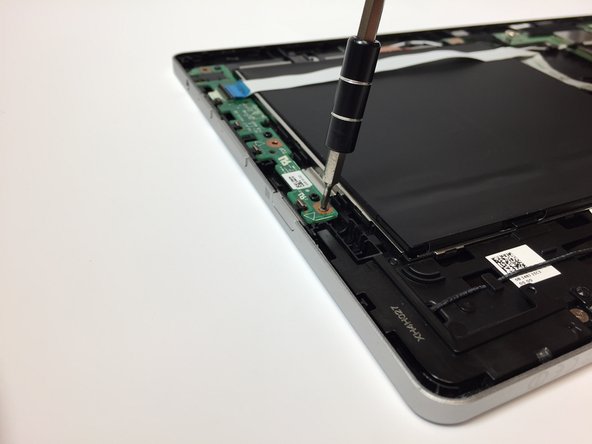

    • Use the Phillips #000 screwdriver to remove the three 3 mm screws on the circuit board.

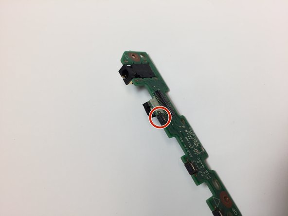

  7. Acer Aspire Switch 10 SW5-012-18MY Power Button Replacement: crwdns2935265:07crwdnd2935265:01crwdnd2935265:02crwdne2935265:0 Acer Aspire Switch 10 SW5-012-18MY Power Button Replacement: crwdns2935265:07crwdnd2935265:02crwdnd2935265:02crwdne2935265:0
    • Carefully remove the circuit board from the device. The power button is located on this piece.
    • To replace the power button on this piece, please go to the page How To Solder and Desolder Connections.
