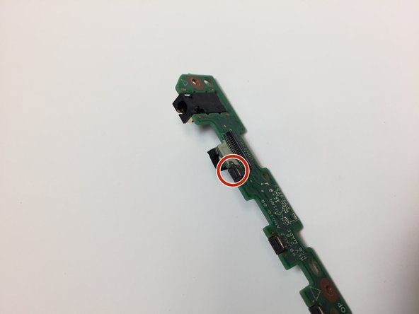

  20. Acer Aspire Switch 10 SW5-012-18MY Display Replacement, Display: crwdns2935265:020crwdnd2935265:01crwdnd2935265:03crwdne2935265:0 Acer Aspire Switch 10 SW5-012-18MY Display Replacement, Display: crwdns2935265:020crwdnd2935265:02crwdnd2935265:03crwdne2935265:0 Acer Aspire Switch 10 SW5-012-18MY Display Replacement, Display: crwdns2935265:020crwdnd2935265:03crwdnd2935265:03crwdne2935265:0
    • Use the Phillips #000 screwdriver to remove the three 3 mm screws on the circuit board.
    • Disregard the battery in the pictures since the battery is already removed at this point in this guide.
