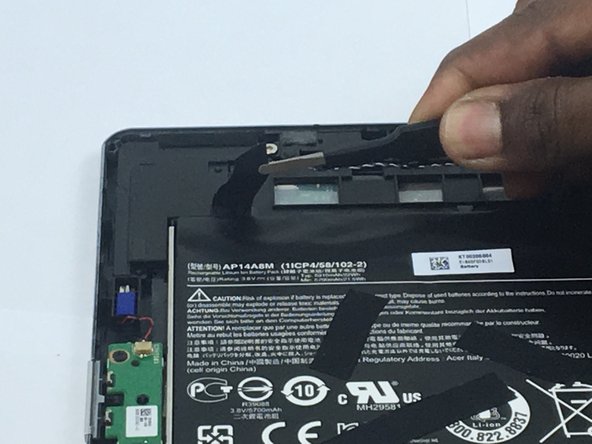

    • Wedge your plastic opening tool into the crevice between the volume button and casing to create space.
    • Slide the plastic opening tool along this crevice to pry apart the backing of the tablet.

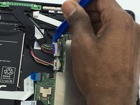

    • There is one zero insertion force connector that needs to be removed.
    • Use your plastic opening tool to flip up the black clip that secures the ribbon cable to the motherboard.
    • Once the clip is flipped up, the ribbon cable will be safe to remove.

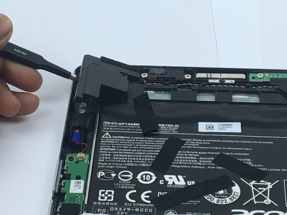

    • Use a pair of tweezers to gently pull up the speaker closest to the motherboard.

    • Remove any tape that may be holding down the speakers or wires in place.

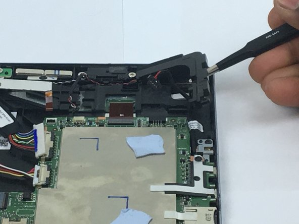

    • Use tweezers to gently pull up the second speaker.
