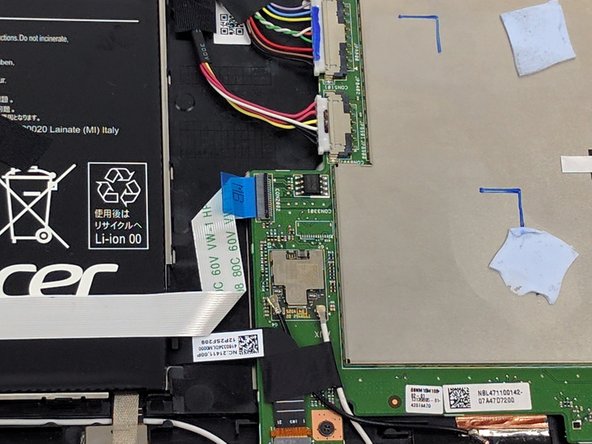

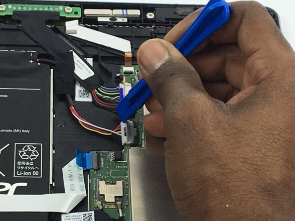

    • There are four zero insertion force connectors that need to be removed.
    • Use your plastic opening tool to flip up the black clips that secure the ribbon cables to the motherboard.
    • Once the clips are flipped up, the ribbon cables will be safe to remove.

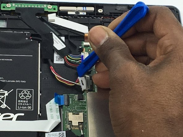

    • Use your plastic opening tool to pry up and lift the antenna cables from the motherboard.
    • The connectors are delicate so use a gentle touch when prying them.
