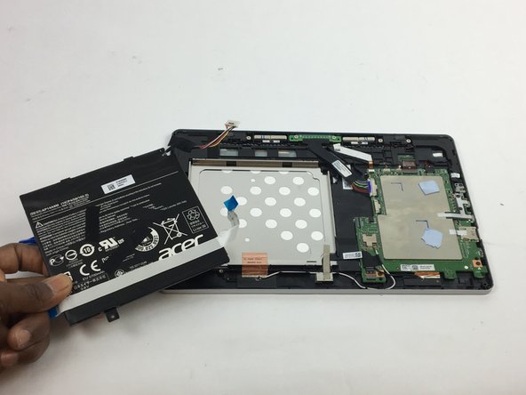

    • Wedge your plastic opening tool into the crevice on the volume rocker and pull down like a lever to create space.
    • Slide the plastic opening tool along the crevice to separate the back plate.
  2. Acer Aspire Switch 10 SW5-011-18R3 Battery Replacement: crwdns2935265:02crwdnd2935265:01crwdnd2935265:01crwdne2935265:0
    • Use your screwdriver with the Phillips PH000 attachment to unscrew the single 4mm screw that holds the battery to the base plate.
  3. Acer Aspire Switch 10 SW5-011-18R3 Battery Replacement: crwdns2935265:03crwdnd2935265:01crwdnd2935265:02crwdne2935265:0 Acer Aspire Switch 10 SW5-011-18R3 Battery Replacement: crwdns2935265:03crwdnd2935265:02crwdnd2935265:02crwdne2935265:0
    • Gently slide the plastic opening tool under the black clip that is attached to the audio ribbon cable.
    • Pull down on the plastic opening tool like a lever to flip the black clip and remove the ribbon cable.
    • The black clip doesn't take much force to lift, so be gentle to avoid breaking it.

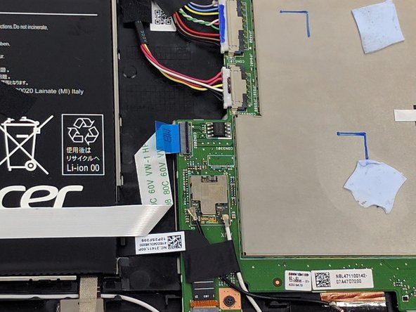

  4. Acer Aspire Switch 10 SW5-011-18R3 Battery Replacement: crwdns2935265:04crwdnd2935265:01crwdnd2935265:02crwdne2935265:0 Acer Aspire Switch 10 SW5-011-18R3 Battery Replacement: crwdns2935265:04crwdnd2935265:02crwdnd2935265:02crwdne2935265:0
    • Remove the tape to expose the left side of the ZIF connector.
  5. Acer Aspire Switch 10 SW5-011-18R3 Battery Replacement: crwdns2935265:05crwdnd2935265:01crwdnd2935265:02crwdne2935265:0 Acer Aspire Switch 10 SW5-011-18R3 Battery Replacement: crwdns2935265:05crwdnd2935265:02crwdnd2935265:02crwdne2935265:0
    • Use a plastic opening tool to flip up the black clip on the ZIF connector.
    • Once the black clip is flipped up, it is safe to remove the audio ribbon cable.
  6. Acer Aspire Switch 10 SW5-011-18R3 Battery Replacement: crwdns2935265:06crwdnd2935265:01crwdnd2935265:03crwdne2935265:0 Acer Aspire Switch 10 SW5-011-18R3 Battery Replacement: crwdns2935265:06crwdnd2935265:02crwdnd2935265:03crwdne2935265:0 Acer Aspire Switch 10 SW5-011-18R3 Battery Replacement: crwdns2935265:06crwdnd2935265:03crwdnd2935265:03crwdne2935265:0
    • Use a plastic opening tool to gently push the edge of the sliding bundle cable connector out.
    • The smaller bundle cable connector is the only one that needs to be removed.
    • Remove the battery.
