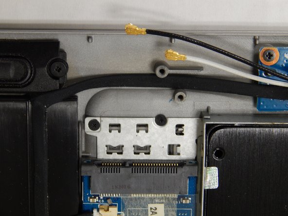

    • Locate the Wi-Fi card (it is near the black rectangular hard drive).
  7. Acer Aspire S3-951-6432 Wi-Fi Card Replacement: crwdns2935265:07crwdnd2935265:01crwdnd2935265:03crwdne2935265:0 Acer Aspire S3-951-6432 Wi-Fi Card Replacement: crwdns2935265:07crwdnd2935265:02crwdnd2935265:03crwdne2935265:0 Acer Aspire S3-951-6432 Wi-Fi Card Replacement: crwdns2935265:07crwdnd2935265:03crwdnd2935265:03crwdne2935265:0

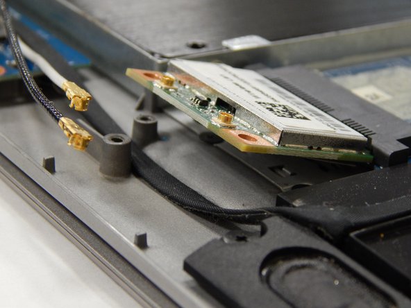

    • Lift up and remove the two cables attached to the Wi-Fi card (one is white and one is black) with the spudger tool.

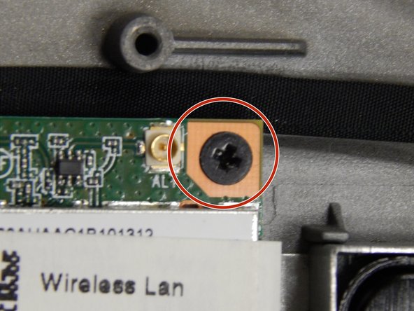

    • Remove the single 3 mm screw located on the top-right side of the Wi-Fi card using the Phillips #0 screwdriver.
    • After replacing the Wi-Fi card, make sure that the cables are aligned. Otherwise, you could damage the metal connectors on the chip.

    • Lift and remove the Wi-Fi card.
