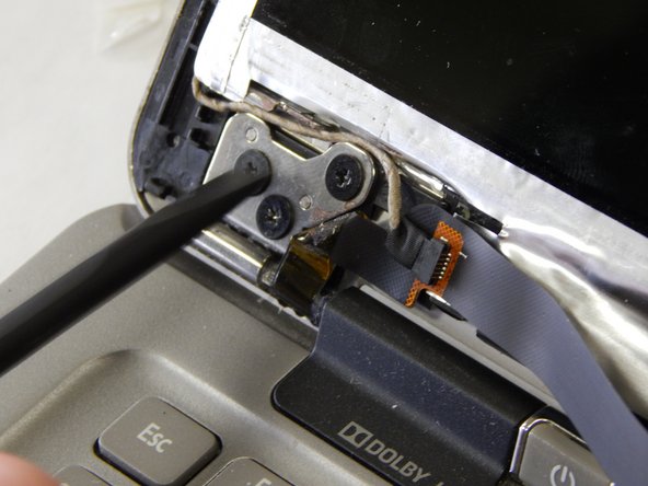

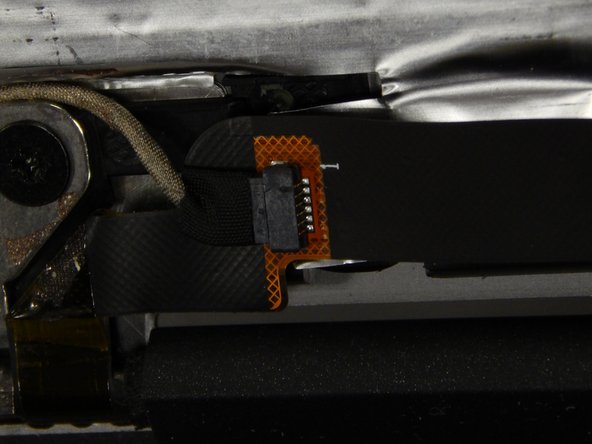

    • Locate the black strip at the bottom of the screen, just above the power button.
    • Use the spudger to disconnect this wire from the screen.
  3. Acer Aspire S3-951-6432 Screen Replacement: crwdns2935265:03crwdnd2935265:01crwdnd2935265:02crwdne2935265:0 Acer Aspire S3-951-6432 Screen Replacement: crwdns2935265:03crwdnd2935265:02crwdnd2935265:02crwdne2935265:0
    • Disconnect the wire leading around the screen with a spudger or a plastic opening tool.

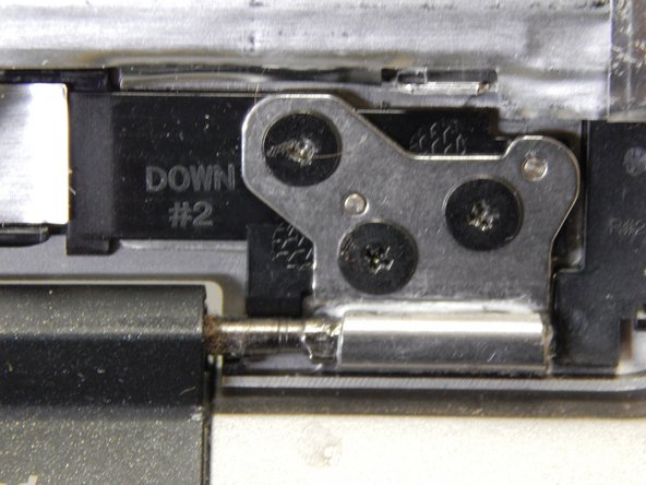

    • Locate the six 3 mm screws (there are three on each side of the screen). Remove them with the Phillips #0 screwdriver.
  5. Acer Aspire S3-951-6432 Screen Replacement: crwdns2935265:05crwdnd2935265:01crwdnd2935265:01crwdne2935265:0
    • Pull the screen (the entire top half) backwards off the hinges of the laptop.
