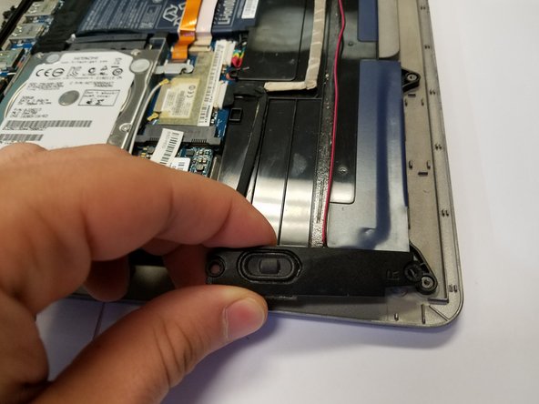

  4. Acer Aspire S3-391-6046 Speaker Replacement, Speaker: crwdns2935265:04crwdnd2935265:01crwdnd2935265:03crwdne2935265:0 Acer Aspire S3-391-6046 Speaker Replacement, Speaker: crwdns2935265:04crwdnd2935265:02crwdnd2935265:03crwdne2935265:0 Acer Aspire S3-391-6046 Speaker Replacement, Speaker: crwdns2935265:04crwdnd2935265:03crwdnd2935265:03crwdne2935265:0
    • Remove the two Phillips #0 screws from the left speaker.
    • Remove the speaker.

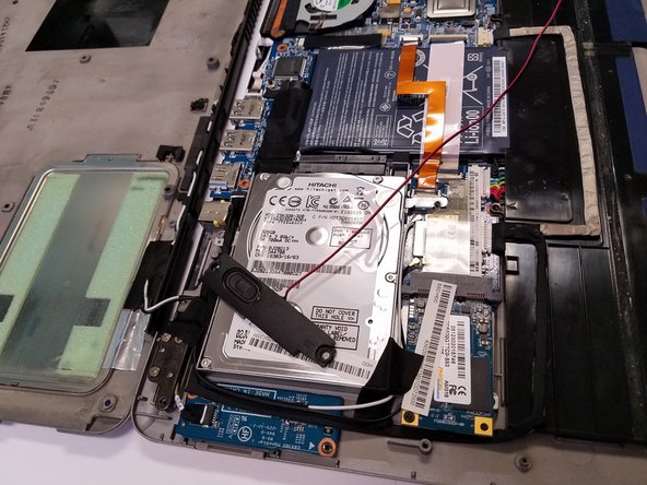

  5. Acer Aspire S3-391-6046 Speaker Replacement: crwdns2935265:05crwdnd2935265:01crwdnd2935265:01crwdne2935265:0
    • Remove the two Phillips #0 screws from the right speaker.
    • Do not lift the speaker.

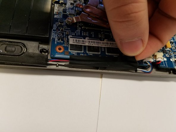

  6. Acer Aspire S3-391-6046 Speaker Replacement: crwdns2935265:06crwdnd2935265:01crwdnd2935265:03crwdne2935265:0 Acer Aspire S3-391-6046 Speaker Replacement: crwdns2935265:06crwdnd2935265:02crwdnd2935265:03crwdne2935265:0 Acer Aspire S3-391-6046 Speaker Replacement: crwdns2935265:06crwdnd2935265:03crwdnd2935265:03crwdne2935265:0
    • Remove the black tape above the right speaker.
    • Remove the right speaker.

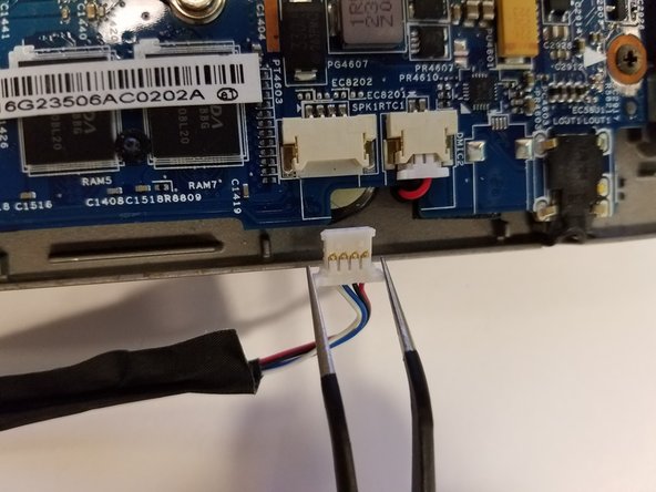

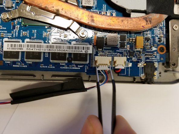

  7. Acer Aspire S3-391-6046 Speaker Replacement: crwdns2935265:07crwdnd2935265:01crwdnd2935265:03crwdne2935265:0 Acer Aspire S3-391-6046 Speaker Replacement: crwdns2935265:07crwdnd2935265:02crwdnd2935265:03crwdne2935265:0 Acer Aspire S3-391-6046 Speaker Replacement: crwdns2935265:07crwdnd2935265:03crwdnd2935265:03crwdne2935265:0
    • Remove the white connector above the black tape.
  8. Acer Aspire S3-391-6046 Speaker Replacement: crwdns2935265:08crwdnd2935265:01crwdnd2935265:01crwdne2935265:0
    • The speakers are fully disconnected.
