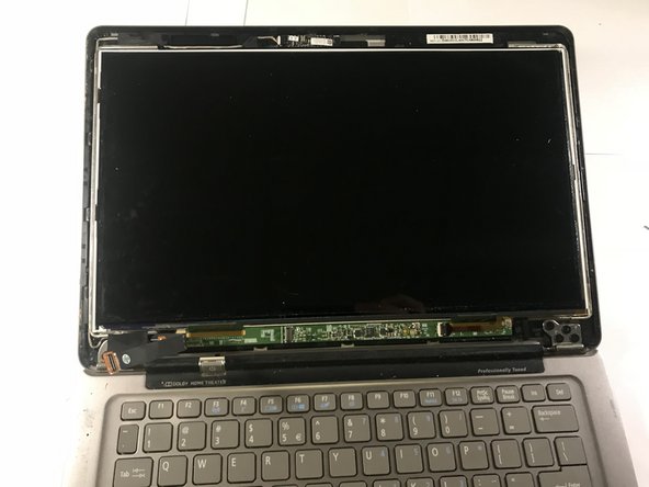

    • Slide the plastic opening tool underneath the frame of your device.
    • Slide the plastic opening tool all around the frame until the entire frame becomes loose and comes off.

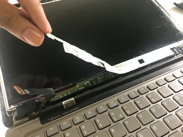

    • On the bottom left of the screen there is a black cable with a piece of white tape over it. Remove the white tape by peeling it off.
    • Slide your opening tool underneath the front of the cable, and pull the cable upwards to disconnect it from its socket.
  3. Acer Aspire S3-391-6046 Screen Replacement: crwdns2935265:03crwdnd2935265:01crwdnd2935265:03crwdne2935265:0 Acer Aspire S3-391-6046 Screen Replacement: crwdns2935265:03crwdnd2935265:02crwdnd2935265:03crwdne2935265:0 Acer Aspire S3-391-6046 Screen Replacement: crwdns2935265:03crwdnd2935265:03crwdnd2935265:03crwdne2935265:0
    • Peel the silver tape from the corner of your laptop until it fully comes off.

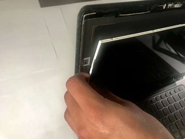

    • Remove the screen by grabbing the edges of the screen and pulling forward.
