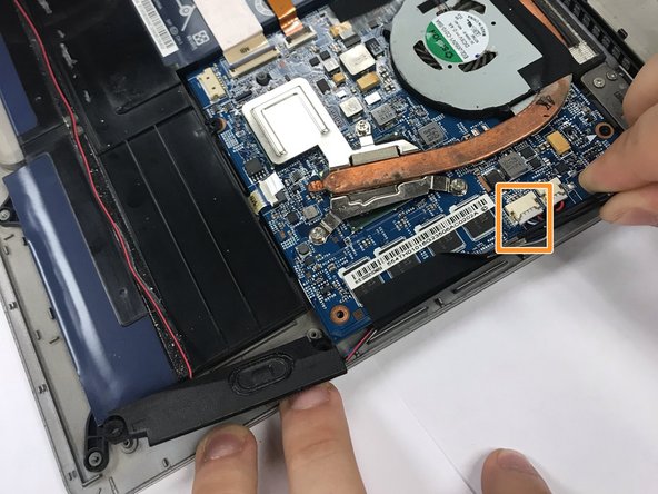

    • Remove the four Phillips #0 screws that are connected to the left and right speakers.
    • Carefully disconnect the wires that connect the speaker to the rest of the computer.

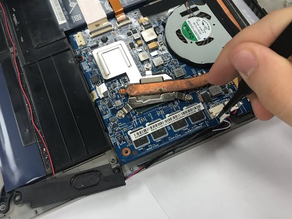

    • Remove the gray wire slowly with tweezers.
    • Carefully peel wire off.

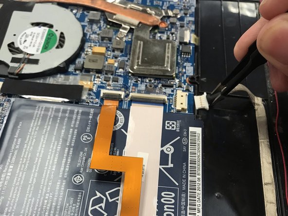

    • Slowly remove the two wires that are to the left of the battery with tweezers in an upward pulling motion.
  8. Acer Aspire S3-391-6046 Keyboard Replacement: crwdns2935265:08crwdnd2935265:01crwdnd2935265:02crwdne2935265:0 Acer Aspire S3-391-6046 Keyboard Replacement: crwdns2935265:08crwdnd2935265:02crwdnd2935265:02crwdne2935265:0
    • Completely remove the battery out of its position.

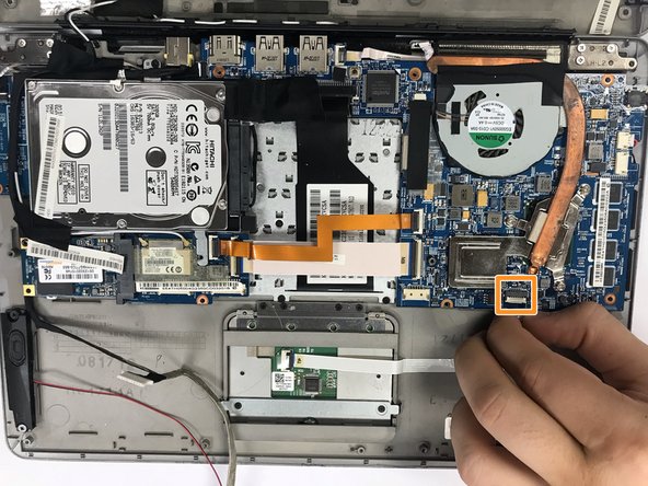

  10. Acer Aspire S3-391-6046 Keyboard Replacement: crwdns2935265:010crwdnd2935265:01crwdnd2935265:02crwdne2935265:0 Acer Aspire S3-391-6046 Keyboard Replacement: crwdns2935265:010crwdnd2935265:02crwdnd2935265:02crwdne2935265:0
    • Flip all of the circuits upwards.
    • Remove all Phillips #0 screws.
    • Remove the keyboard.
