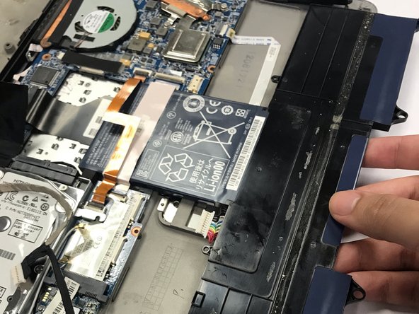

  4. Acer Aspire S3-391-6046 Battery Replacement, Battery: crwdns2935265:04crwdnd2935265:01crwdnd2935265:01crwdne2935265:0
    • With the Phillips #1 screwdriver, remove the two 5mm screws located on either side of the battery.
  5. Acer Aspire S3-391-6046 Battery Replacement: crwdns2935265:05crwdnd2935265:01crwdnd2935265:02crwdne2935265:0 Acer Aspire S3-391-6046 Battery Replacement: crwdns2935265:05crwdnd2935265:02crwdnd2935265:02crwdne2935265:0
    • Unplug the three white plugs from their sockets using tweezers by pinching the plugs and pulling them outwards.
    • Pulling with too much force will damage the plugs.
  6. Acer Aspire S3-391-6046 Battery Replacement: crwdns2935265:06crwdnd2935265:01crwdnd2935265:02crwdne2935265:0 Acer Aspire S3-391-6046 Battery Replacement: crwdns2935265:06crwdnd2935265:02crwdnd2935265:02crwdne2935265:0

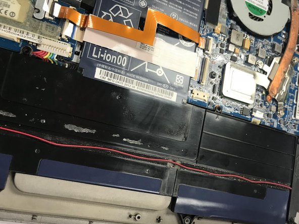

    • Pull upwards on the plugs located on top of your battery until they have completely come off.
  7. Acer Aspire S3-391-6046 Battery Replacement: crwdns2935265:07crwdnd2935265:01crwdnd2935265:02crwdne2935265:0 Acer Aspire S3-391-6046 Battery Replacement: crwdns2935265:07crwdnd2935265:02crwdnd2935265:02crwdne2935265:0
    • Remove the electrical tape holding down the battery by peeling it upwards.
    • Grab the battery from the bottom and slide it out towards the direction of the bottom of the battery.
