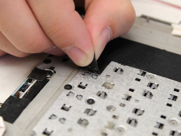

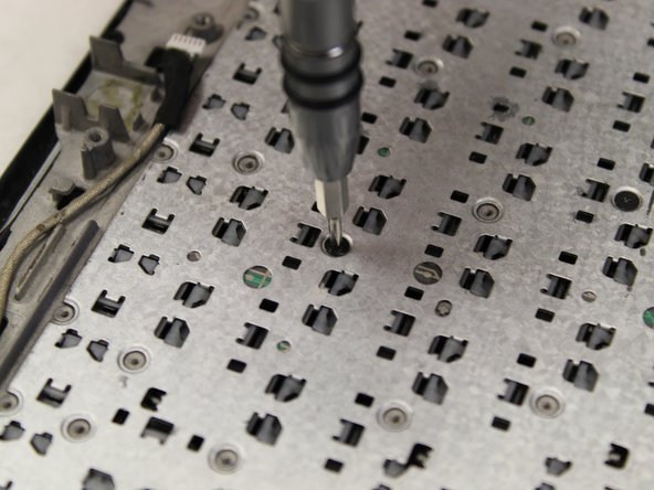

  8. Acer Aspire S3 MS2346 Keyboard Replacement, Keyboard: crwdns2935265:08crwdnd2935265:01crwdnd2935265:03crwdne2935265:0 Acer Aspire S3 MS2346 Keyboard Replacement, Keyboard: crwdns2935265:08crwdnd2935265:02crwdnd2935265:03crwdne2935265:0 Acer Aspire S3 MS2346 Keyboard Replacement, Keyboard: crwdns2935265:08crwdnd2935265:03crwdnd2935265:03crwdne2935265:0
    • The 30 1mm PH000 screws holding the keyboard in place will be distributed all over the back.
    • You will need to gently pry up the black tape to expose the remaining screws.
  9. Acer Aspire S3 MS2346 Keyboard Replacement: crwdns2935265:09crwdnd2935265:01crwdnd2935265:01crwdne2935265:0
    • Gently lift the board exposing the keyboard assembly.
