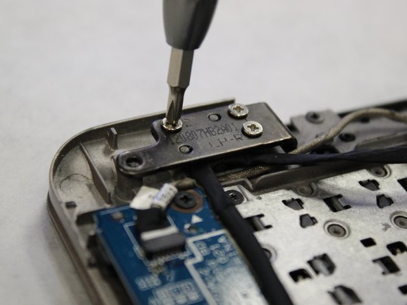

  5. Acer Aspire S3 MS2346 Display Assembly Replacement, Display Assembly: crwdns2935265:05crwdnd2935265:01crwdnd2935265:02crwdne2935265:0 Acer Aspire S3 MS2346 Display Assembly Replacement, Display Assembly: crwdns2935265:05crwdnd2935265:02crwdnd2935265:02crwdne2935265:0
    • Unscrew the 10 5mm PH00 screws from the hinges attaching the display assembly to the base.
  6. Acer Aspire S3 MS2346 Display Assembly Replacement: crwdns2935265:06crwdnd2935265:01crwdnd2935265:01crwdne2935265:0
    • Unlatch the screen from the frame
