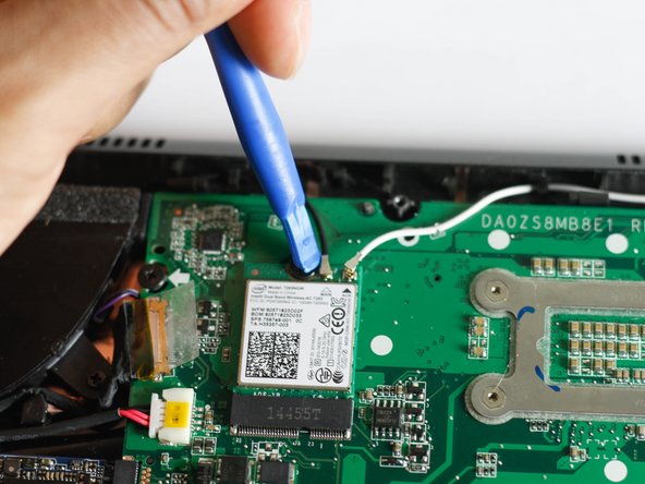

  3. Acer Aspire R7-371T-72CF Wifi Chip Replacement: crwdns2935265:03crwdnd2935265:01crwdnd2935265:03crwdne2935265:0 Acer Aspire R7-371T-72CF Wifi Chip Replacement: crwdns2935265:03crwdnd2935265:02crwdnd2935265:03crwdne2935265:0 Acer Aspire R7-371T-72CF Wifi Chip Replacement: crwdns2935265:03crwdnd2935265:03crwdnd2935265:03crwdne2935265:0
    • Locate the wifi chip, as shown to the left.
    • The chip can by identified by the white and black wires connected to it, as well as a single screw holding it in place.

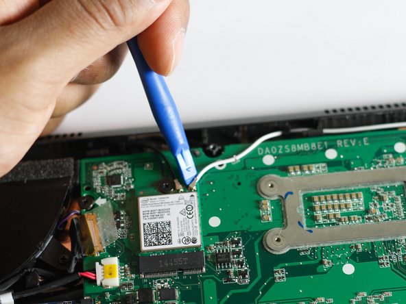

  4. Acer Aspire R7-371T-72CF Wifi Chip Replacement: crwdns2935265:04crwdnd2935265:01crwdnd2935265:03crwdne2935265:0 Acer Aspire R7-371T-72CF Wifi Chip Replacement: crwdns2935265:04crwdnd2935265:02crwdnd2935265:03crwdne2935265:0 Acer Aspire R7-371T-72CF Wifi Chip Replacement: crwdns2935265:04crwdnd2935265:03crwdnd2935265:03crwdne2935265:0
    • Locate the 2 antenna wires connected to the chip.
    • One is black, and the other is white.
    • Use a spudger or plastic opening tool to carefully disconnect the wires from the chip by prying upwards.
    • The connectors 'click' into place, like a button.

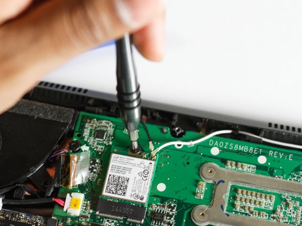

  5. Acer Aspire R7-371T-72CF Wifi Chip Replacement: crwdns2935265:05crwdnd2935265:01crwdnd2935265:02crwdne2935265:0 Acer Aspire R7-371T-72CF Wifi Chip Replacement: crwdns2935265:05crwdnd2935265:02crwdnd2935265:02crwdne2935265:0
    • Remove the Phillips #00 6mm securing screw using your screwdriver.
