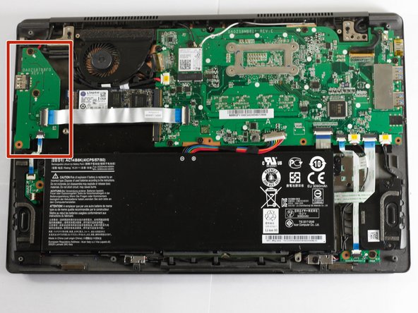

    • Locate the USB chip, as shown to the left.
    • This can be identified by its location to the left of the cooling fan and above the battery to the left.

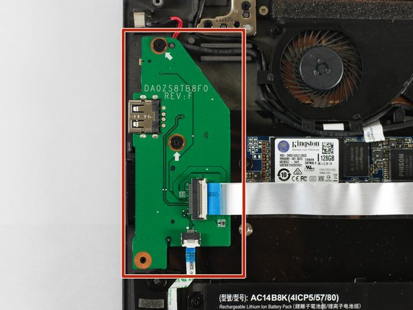

  4. Acer Aspire R7-371T-72CF USB Chip Replacement: crwdns2935265:04crwdnd2935265:01crwdnd2935265:03crwdne2935265:0 Acer Aspire R7-371T-72CF USB Chip Replacement: crwdns2935265:04crwdnd2935265:02crwdnd2935265:03crwdne2935265:0 Acer Aspire R7-371T-72CF USB Chip Replacement: crwdns2935265:04crwdnd2935265:03crwdnd2935265:03crwdne2935265:0
    • Unscrew the two Phillips #00 4mm screws located on the USB chip.

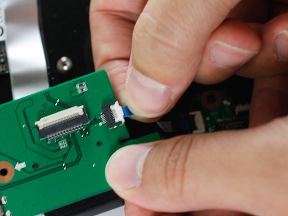

  5. Acer Aspire R7-371T-72CF USB Chip Replacement: crwdns2935265:05crwdnd2935265:01crwdnd2935265:03crwdne2935265:0 Acer Aspire R7-371T-72CF USB Chip Replacement: crwdns2935265:05crwdnd2935265:02crwdnd2935265:03crwdne2935265:0 Acer Aspire R7-371T-72CF USB Chip Replacement: crwdns2935265:05crwdnd2935265:03crwdnd2935265:03crwdne2935265:0
    • Push the white panel upwards to unlock the cable and then remove the cable.
    • Repeat for the second cable.
