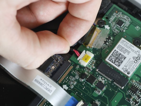

  4. Acer Aspire R7-371T-72CF Power Port Replacement: crwdns2935265:04crwdnd2935265:01crwdnd2935265:03crwdne2935265:0 Acer Aspire R7-371T-72CF Power Port Replacement: crwdns2935265:04crwdnd2935265:02crwdnd2935265:03crwdne2935265:0 Acer Aspire R7-371T-72CF Power Port Replacement: crwdns2935265:04crwdnd2935265:03crwdnd2935265:03crwdne2935265:0
    • Disconnect the wiring from the motherboard, and pull out the rest of the wire carefully.
    • Make sure the wire is not caught on anything before pulling.

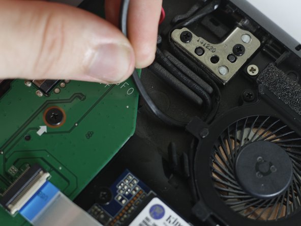

  5. Acer Aspire R7-371T-72CF Power Port Replacement: crwdns2935265:05crwdnd2935265:01crwdnd2935265:01crwdne2935265:0
    • Pull out the power connector by pulling upwards on the wires.
    • This may require a small amount of force, but should pop out with some pressure.
