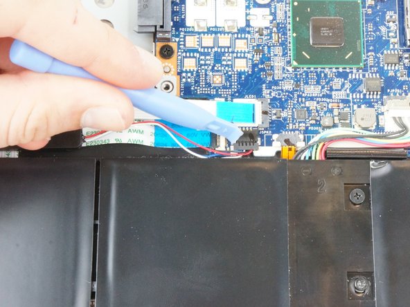

  4. Acer Aspire R7 Speakers Replacement, Speakers: crwdns2935265:04crwdnd2935265:01crwdnd2935265:02crwdne2935265:0 Acer Aspire R7 Speakers Replacement, Speakers: crwdns2935265:04crwdnd2935265:02crwdnd2935265:02crwdne2935265:0
    • Locate the clip attaching the right-side speakers to the motherboard.
    • Carefully pull on the clip until it detaches from the motherboard.
    • Use a plastic opening tool if needed.
