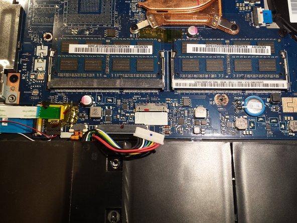

    5. Acer Aspire R7 Display Assembly Replacement, Disconnect and Remove the Battery: crwdns2935265:05crwdnd2935265:01crwdnd2935265:02crwdne2935265:0 Acer Aspire R7 Display Assembly Replacement, Disconnect and Remove the Battery: crwdns2935265:05crwdnd2935265:02crwdnd2935265:02crwdne2935265:0
      • Disconnect the battery connector from the motherboard.
    6. Acer Aspire R7 Display Assembly Replacement: crwdns2935265:06crwdnd2935265:01crwdnd2935265:02crwdne2935265:0 Acer Aspire R7 Display Assembly Replacement: crwdns2935265:06crwdnd2935265:02crwdnd2935265:02crwdne2935265:0
      • Remove the two battery screws.
    7. Acer Aspire R7 Display Assembly Replacement: crwdns2935265:07crwdnd2935265:01crwdnd2935265:02crwdne2935265:0 Acer Aspire R7 Display Assembly Replacement: crwdns2935265:07crwdnd2935265:02crwdnd2935265:02crwdne2935265:0
      • Remove the battery by lifting it up carfully.

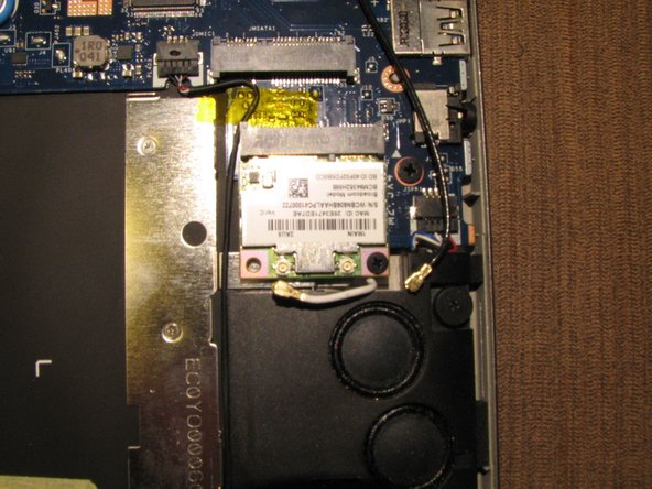

    10. Acer Aspire R7 Display Assembly Replacement, WiFi Card Removal: crwdns2935265:010crwdnd2935265:01crwdnd2935265:02crwdne2935265:0 Acer Aspire R7 Display Assembly Replacement, WiFi Card Removal: crwdns2935265:010crwdnd2935265:02crwdnd2935265:02crwdne2935265:0
      • Disconnect the black and white WiFi antenna wires.
    11. Acer Aspire R7 Display Assembly Replacement: crwdns2935265:011crwdnd2935265:01crwdnd2935265:03crwdne2935265:0 Acer Aspire R7 Display Assembly Replacement: crwdns2935265:011crwdnd2935265:02crwdnd2935265:03crwdne2935265:0 Acer Aspire R7 Display Assembly Replacement: crwdns2935265:011crwdnd2935265:03crwdnd2935265:03crwdne2935265:0
      • Unscrew the screw holding down the WiFi card.
      • Remove the WiFi card.
    12. Acer Aspire R7 Display Assembly Replacement, Disconnecting Motherboard Connections: crwdns2935265:012crwdnd2935265:01crwdnd2935265:03crwdne2935265:0 Acer Aspire R7 Display Assembly Replacement, Disconnecting Motherboard Connections: crwdns2935265:012crwdnd2935265:02crwdnd2935265:03crwdne2935265:0 Acer Aspire R7 Display Assembly Replacement, Disconnecting Motherboard Connections: crwdns2935265:012crwdnd2935265:03crwdnd2935265:03crwdne2935265:0
      • Disconnect the two keyboard ribbon cables
      • Disconnect the left speaker wire.
      • Disconnect the front lights ribbon cable.

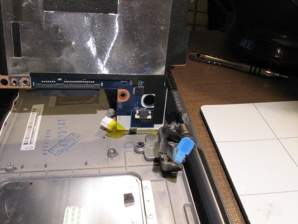

      • Disconnect the I/O board ribbon cable.
    13. Acer Aspire R7 Display Assembly Replacement: crwdns2935265:013crwdnd2935265:01crwdnd2935265:02crwdne2935265:0 Acer Aspire R7 Display Assembly Replacement: crwdns2935265:013crwdnd2935265:02crwdnd2935265:02crwdne2935265:0
      • Disconnect the DC jack cable.
    14. Acer Aspire R7 Display Assembly Replacement: crwdns2935265:014crwdnd2935265:01crwdnd2935265:02crwdne2935265:0 Acer Aspire R7 Display Assembly Replacement: crwdns2935265:014crwdnd2935265:02crwdnd2935265:02crwdne2935265:0
      • Disconnect the two display cables.
    15. Acer Aspire R7 Display Assembly Replacement: crwdns2935265:015crwdnd2935265:01crwdnd2935265:02crwdne2935265:0 Acer Aspire R7 Display Assembly Replacement: crwdns2935265:015crwdnd2935265:02crwdnd2935265:02crwdne2935265:0

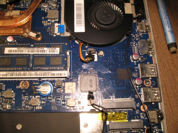

      • Disconnect the heat sink fan wire.
      • Disconnect the microphone wire.
    16. Acer Aspire R7 Display Assembly Replacement: crwdns2935265:016crwdnd2935265:01crwdnd2935265:02crwdne2935265:0 Acer Aspire R7 Display Assembly Replacement: crwdns2935265:016crwdnd2935265:02crwdnd2935265:02crwdne2935265:0
      • Disconnect the right speaker wire.

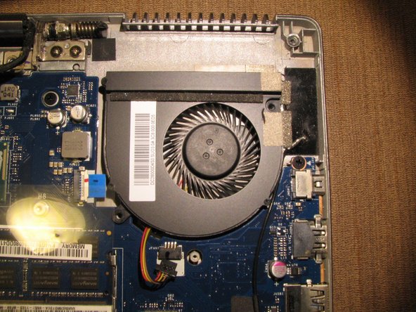

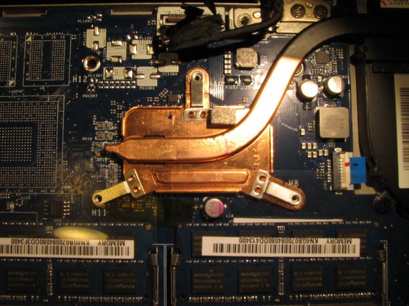

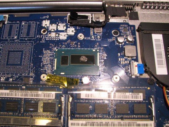

    17. Acer Aspire R7 Display Assembly Replacement, CPU Heat Sink and Fan Removal: crwdns2935265:017crwdnd2935265:01crwdnd2935265:03crwdne2935265:0 Acer Aspire R7 Display Assembly Replacement, CPU Heat Sink and Fan Removal: crwdns2935265:017crwdnd2935265:02crwdnd2935265:03crwdne2935265:0 Acer Aspire R7 Display Assembly Replacement, CPU Heat Sink and Fan Removal: crwdns2935265:017crwdnd2935265:03crwdnd2935265:03crwdne2935265:0
      • Remove the 3 heat sink screws.
      • Lift up the heat sink from the motherboard and remove it.
      • When reinstalling the heat sink during reassembly, make sure to clean off the old thermal paste from the CPU and heat sink with Artic Silver ArtiClean. Then put a grain of rice sized amount of new Artic Silver thermal paste on the CPU so it won't overheat. See 3rd picture.

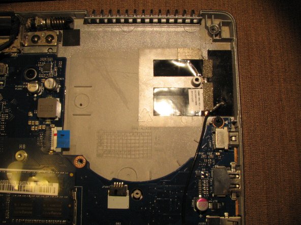

    18. Acer Aspire R7 Display Assembly Replacement: crwdns2935265:018crwdnd2935265:01crwdnd2935265:03crwdne2935265:0 Acer Aspire R7 Display Assembly Replacement: crwdns2935265:018crwdnd2935265:02crwdnd2935265:03crwdne2935265:0 Acer Aspire R7 Display Assembly Replacement: crwdns2935265:018crwdnd2935265:03crwdnd2935265:03crwdne2935265:0
      • Remove the 2 heat sink fan screws.
      • Remove the heat sink fan.

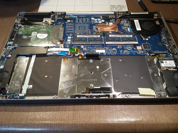

    20. Acer Aspire R7 Display Assembly Replacement, Motherboard Removal: crwdns2935265:020crwdnd2935265:01crwdnd2935265:02crwdne2935265:0 Acer Aspire R7 Display Assembly Replacement, Motherboard Removal: crwdns2935265:020crwdnd2935265:02crwdnd2935265:02crwdne2935265:0
      • Remove the 3 motherboard screws.
      • Remove the motherboard by lifting it up very carefully as the power button ribbon cable is still connected to the left under side of the motherboard. See step 21.

      • Remove the power button ribbon cable from the motherboard.
