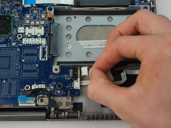

    • Locate the AC Socket ribbon connector
    • Loosen the ribbon connector using the plastic opening tool
    • Pull the ribbon connector away from the motherboard

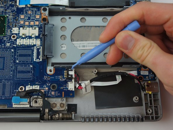

  5. Acer Aspire R7 AC Socket Replacement: crwdns2935265:05crwdnd2935265:01crwdnd2935265:02crwdne2935265:0 Acer Aspire R7 AC Socket Replacement: crwdns2935265:05crwdnd2935265:02crwdnd2935265:02crwdne2935265:0
    • Use the plastic opening tool to pry up on the yellow tabs holding the Socket in place
    • There is two sided tape holding this component to the case
    • Once the tape on the Socket is loose, pull up and away from the case to remove it.
