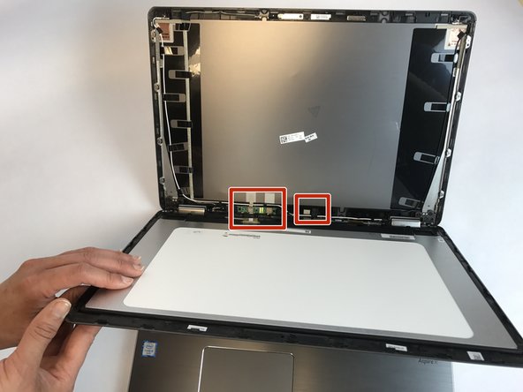

  3. Acer Aspire R5-571T-59DC Display Replacement, Display: crwdns2935265:03crwdnd2935265:01crwdnd2935265:02crwdne2935265:0 Acer Aspire R5-571T-59DC Display Replacement, Display: crwdns2935265:03crwdnd2935265:02crwdnd2935265:02crwdne2935265:0
    • Using a plastic opening tool, pry the back cover away from the screen.
  4. Acer Aspire R5-571T-59DC Display Replacement: crwdns2935265:04crwdnd2935265:01crwdnd2935265:01crwdne2935265:0
    • Remove the tape covering the connector cables once the screen is separated from the display board.
  5. Acer Aspire R5-571T-59DC Display Replacement: crwdns2935265:05crwdnd2935265:01crwdnd2935265:02crwdne2935265:0 Acer Aspire R5-571T-59DC Display Replacement: crwdns2935265:05crwdnd2935265:02crwdnd2935265:02crwdne2935265:0
    • Use a spudger to flip up the retaining flap on the display ribbon cable ZIF socket.
    • Pull the ribbon cables out of the sockets.
