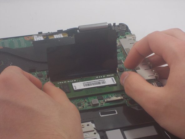

  4. Acer Aspire R5-571T-57Z0 RAM Replacement, RAM: crwdns2935265:04crwdnd2935265:01crwdnd2935265:01crwdne2935265:0
    • Lift up the black flap covering the RAM.
  5. Acer Aspire R5-571T-57Z0 RAM Replacement: crwdns2935265:05crwdnd2935265:01crwdnd2935265:02crwdne2935265:0 Acer Aspire R5-571T-57Z0 RAM Replacement: crwdns2935265:05crwdnd2935265:02crwdnd2935265:02crwdne2935265:0
    • Push the pins outward on each side of the RAM.
  6. Acer Aspire R5-571T-57Z0 RAM Replacement: crwdns2935265:06crwdnd2935265:01crwdnd2935265:02crwdne2935265:0 Acer Aspire R5-571T-57Z0 RAM Replacement: crwdns2935265:06crwdnd2935265:02crwdnd2935265:02crwdne2935265:0
    • Take out the RAM by lifting it upwards.
