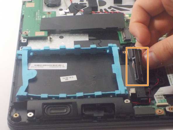

  4. Acer Aspire R5-571T-57Z0 Hard Drive Replacement, Hard Drive: crwdns2935265:04crwdnd2935265:01crwdnd2935265:02crwdne2935265:0 Acer Aspire R5-571T-57Z0 Hard Drive Replacement, Hard Drive: crwdns2935265:04crwdnd2935265:02crwdnd2935265:02crwdne2935265:0
    • Lift the hard drive either by hand or with a spudger.
    • Unplug the connector cable to remove the hard drive from the laptop.
