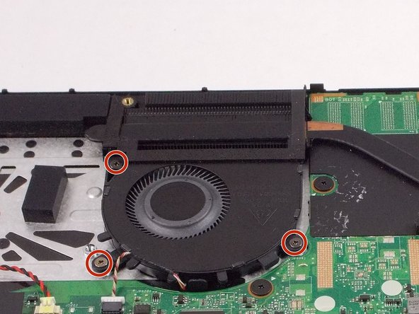

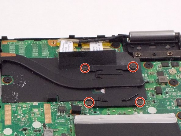

    • Remove the seven 4.0 mm screws attaching the fan to the laptop using a Phillips #00 screwdriver.

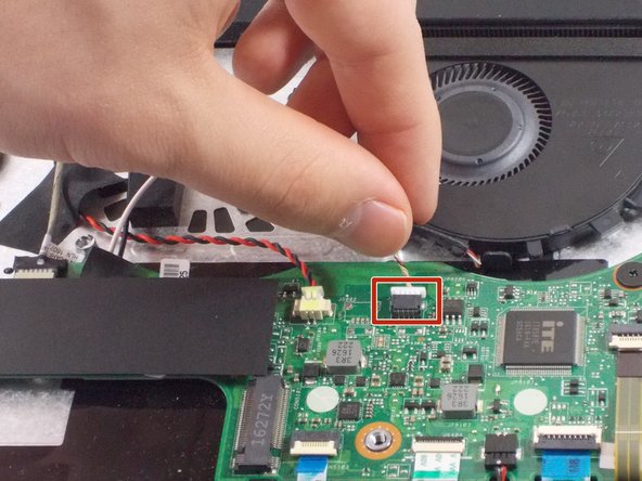

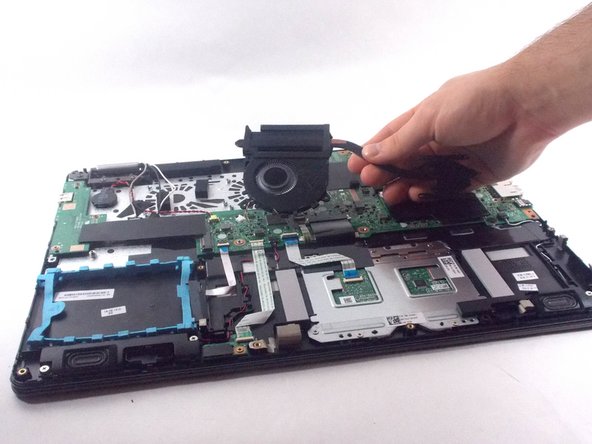

    • Detach the fan cable from the motherboard.
    • Remove the fan from the laptop.
