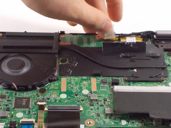

    • Peel back the stickers from the display cable.

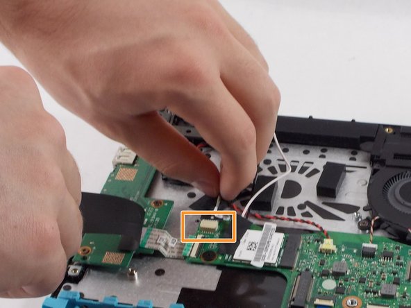

    • Hold back the film protecting the Wi-Fi card.
    • Disconnect the touch screen cable.

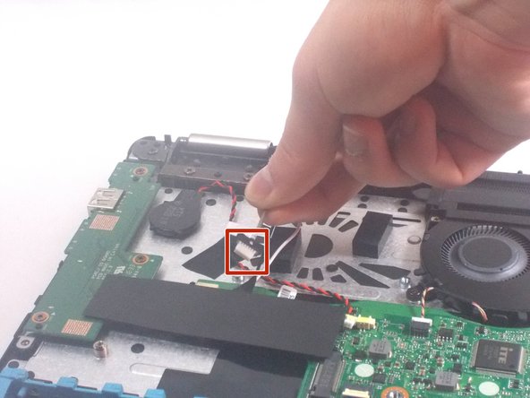

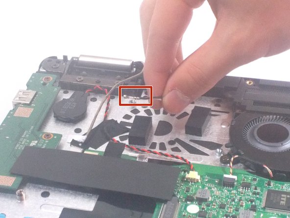

    • Pull back the tape covering the connectors.
    • Detach the two connectors (one black wire, one white wire).

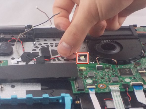

    • Disconnect the touch control cable next to the black film.

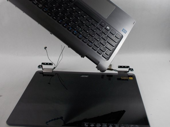

    • Flip over the laptop and pull back to remove the display assembly.

The instructions say to just pull bak the stickers for the display, I assume those should also be disconnected?
