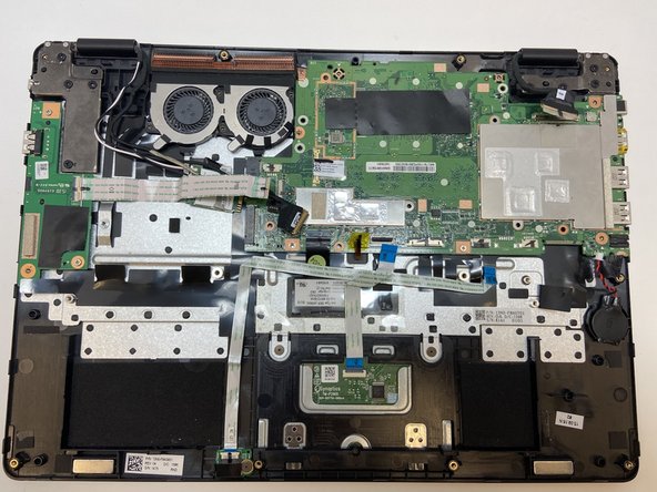

  4. Acer Aspire R5-471T-52EE Speakers Replacement, Speakers: crwdns2935265:04crwdnd2935265:01crwdnd2935265:02crwdne2935265:0 Acer Aspire R5-471T-52EE Speakers Replacement, Speakers: crwdns2935265:04crwdnd2935265:02crwdnd2935265:02crwdne2935265:0
    • Gently peel off all of the black take that sticks down the speaker cables.
    • Disconnect the two ribbon cables to allow the speaker cable to be removed from underneath.
    • Unplug the speaker cable from the motherboard.
    • Using a spudger, gently remove the speakers from the device.
