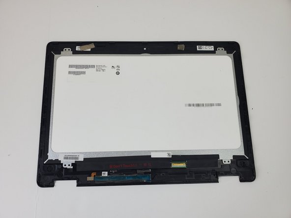

  4. Acer Aspire R5-471T-52EE Screen Replacement: crwdns2935265:04crwdnd2935265:01crwdnd2935265:01crwdne2935265:0
    • Remove the eight 3mm screws on the hinges using the Phillips #1 screwdriver.
    • Now that the hinges have been unfastened, carefully separate the screen and screen casing from the other half of the computer.
  5. Acer Aspire R5-471T-52EE Screen Replacement: crwdns2935265:05crwdnd2935265:01crwdnd2935265:02crwdne2935265:0 Acer Aspire R5-471T-52EE Screen Replacement: crwdns2935265:05crwdnd2935265:02crwdnd2935265:02crwdne2935265:0
    • Using a spudger or an opening pick, pop open the case holding the screen. Follow the line where the two pieces of the case meet all around the screen.
    • Remove the display assembly from the device.
