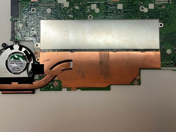

  7. Acer Aspire R5-471T-52EE Fan Replacement, Fan: crwdns2935265:07crwdnd2935265:01crwdnd2935265:02crwdne2935265:0 Acer Aspire R5-471T-52EE Fan Replacement, Fan: crwdns2935265:07crwdnd2935265:02crwdnd2935265:02crwdne2935265:0
    • Flip the motherboard over so that the silver and copper covers are exposed.
    • Use the opening tool to gently lift the copper cover off the board by sliding the tool underneath the edge.
  8. Acer Aspire R5-471T-52EE Fan Replacement: crwdns2935265:08crwdnd2935265:01crwdnd2935265:01crwdne2935265:0
    • Unplug the two power cables for the fans from the motherboard.
    • Remove the four mounting screws from the motherboard using a Phillips #00 screwdriver.
  9. Acer Aspire R5-471T-52EE Fan Replacement: crwdns2935265:09crwdnd2935265:01crwdnd2935265:01crwdne2935265:0
    • Gently remove the fans from the motherboard.
