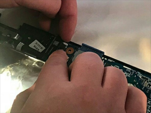

  6. Acer Aspire R11 R3-131T-C1Z5 Motherboard Replacement, Motherboard: crwdns2935265:06crwdnd2935265:01crwdnd2935265:01crwdne2935265:0
    • Locate the blue circuit board. This can be identified by locating the two USB ports.
  7. Acer Aspire R11 R3-131T-C1Z5 Motherboard Replacement: crwdns2935265:07crwdnd2935265:01crwdnd2935265:01crwdne2935265:0
    • Remove the four 12.7 mm PH#0 screws that are surrounded by a copper ring.
  8. Acer Aspire R11 R3-131T-C1Z5 Motherboard Replacement: crwdns2935265:08crwdnd2935265:01crwdnd2935265:03crwdne2935265:0 Acer Aspire R11 R3-131T-C1Z5 Motherboard Replacement: crwdns2935265:08crwdnd2935265:02crwdnd2935265:03crwdne2935265:0 Acer Aspire R11 R3-131T-C1Z5 Motherboard Replacement: crwdns2935265:08crwdnd2935265:03crwdnd2935265:03crwdne2935265:0
    • Unclip and remove the three ribbon cables. The ribbon cables clip in with a white clip.
    • Disconnect the three wires from the blue circuit board.
  9. Acer Aspire R11 R3-131T-C1Z5 Motherboard Replacement: crwdns2935265:09crwdnd2935265:01crwdnd2935265:01crwdne2935265:0
    • Remove the blue circuit board.
