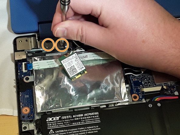

  6. Acer Aspire R11 R3-131T-C1Z5 Hinges Replacement, Hinges: crwdns2935265:06crwdnd2935265:01crwdnd2935265:02crwdne2935265:0 Acer Aspire R11 R3-131T-C1Z5 Hinges Replacement, Hinges: crwdns2935265:06crwdnd2935265:02crwdnd2935265:02crwdne2935265:0
    • Located at the top are two silver plates that connect to the laptop screen. These are your hinges.
    • Remove the two 12.7 mm PH#0 screws on each hinge.

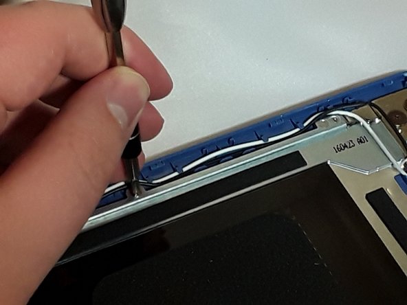

  9. Acer Aspire R11 R3-131T-C1Z5 Hinges Replacement: crwdns2935265:09crwdnd2935265:01crwdnd2935265:01crwdne2935265:0
    • Insert the tip of the metal spudger at the seam to pry the screen display from the cover.
  10. Acer Aspire R11 R3-131T-C1Z5 Hinges Replacement: crwdns2935265:010crwdnd2935265:01crwdnd2935265:01crwdne2935265:0
    • After the front and back of the screen are separated, look for any wires the may prevent complete separation. There are 2 wires located by the hinges.
    • Disconnect each wire and remove the tape if necessary. All screen wires tucked into the plastic part of the hinges can be exposed by pulling on them.

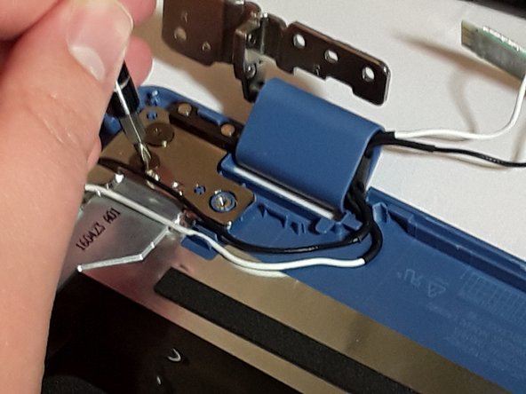

  11. Acer Aspire R11 R3-131T-C1Z5 Hinges Replacement: crwdns2935265:011crwdnd2935265:01crwdnd2935265:01crwdne2935265:0
    • Locate the metal hinge on each side of the blue half of the screen.
  12. Acer Aspire R11 R3-131T-C1Z5 Hinges Replacement: crwdns2935265:012crwdnd2935265:01crwdnd2935265:03crwdne2935265:0 Acer Aspire R11 R3-131T-C1Z5 Hinges Replacement: crwdns2935265:012crwdnd2935265:02crwdnd2935265:03crwdne2935265:0 Acer Aspire R11 R3-131T-C1Z5 Hinges Replacement: crwdns2935265:012crwdnd2935265:03crwdnd2935265:03crwdne2935265:0
    • Remove the five 12.7 mm PH#0 screws.
  13. Acer Aspire R11 R3-131T-C1Z5 Hinges Replacement: crwdns2935265:013crwdnd2935265:01crwdnd2935265:01crwdne2935265:0
    • Pull off the blue plastic located at the top of the hinge.
