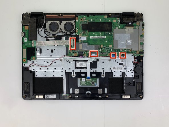

  6. Acer Aspire R R5-471T-51UN Trackpad Replacement, Keyboard: crwdns2935265:06crwdnd2935265:01crwdnd2935265:03crwdne2935265:0 Acer Aspire R R5-471T-51UN Trackpad Replacement, Keyboard: crwdns2935265:06crwdnd2935265:02crwdnd2935265:03crwdne2935265:0 Acer Aspire R R5-471T-51UN Trackpad Replacement, Keyboard: crwdns2935265:06crwdnd2935265:03crwdnd2935265:03crwdne2935265:0
    • Use the spudger to flip up the locking tabs on each of the four ZIF cable connectors.
    • Remove each of the ribbon cables from their connectors.

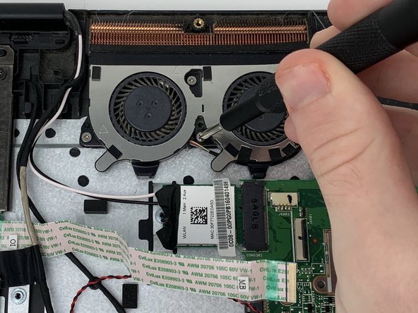

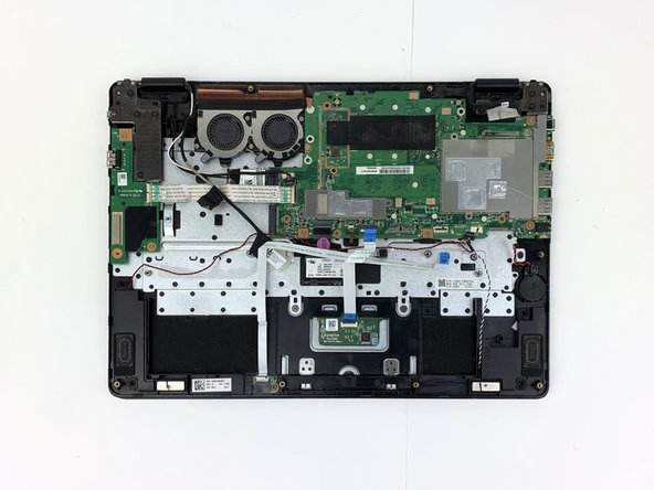

  7. Acer Aspire R R5-471T-51UN Trackpad Replacement: crwdns2935265:07crwdnd2935265:01crwdnd2935265:03crwdne2935265:0 Acer Aspire R R5-471T-51UN Trackpad Replacement: crwdns2935265:07crwdnd2935265:02crwdnd2935265:03crwdne2935265:0 Acer Aspire R R5-471T-51UN Trackpad Replacement: crwdns2935265:07crwdnd2935265:03crwdnd2935265:03crwdne2935265:0

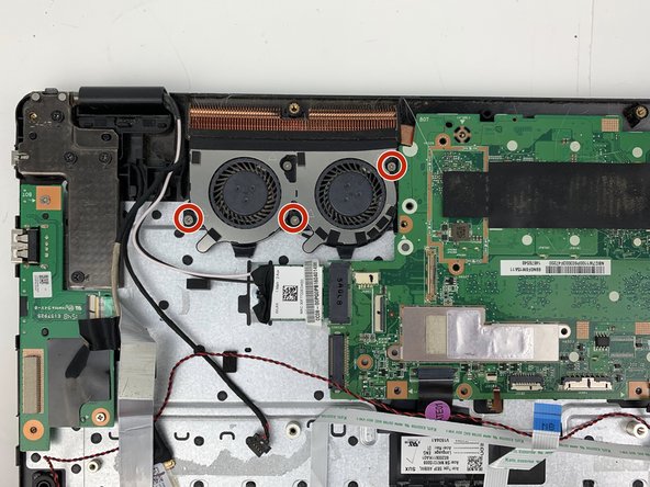

    • Using the Phillips #0 screwdriver, remove the eight 3 mm screws holding in the motherboard and the three 3 mm screws holding down the fan.
  8. Acer Aspire R R5-471T-51UN Trackpad Replacement: crwdns2935265:08crwdnd2935265:01crwdnd2935265:03crwdne2935265:0 Acer Aspire R R5-471T-51UN Trackpad Replacement: crwdns2935265:08crwdnd2935265:02crwdnd2935265:03crwdne2935265:0 Acer Aspire R R5-471T-51UN Trackpad Replacement: crwdns2935265:08crwdnd2935265:03crwdnd2935265:03crwdne2935265:0

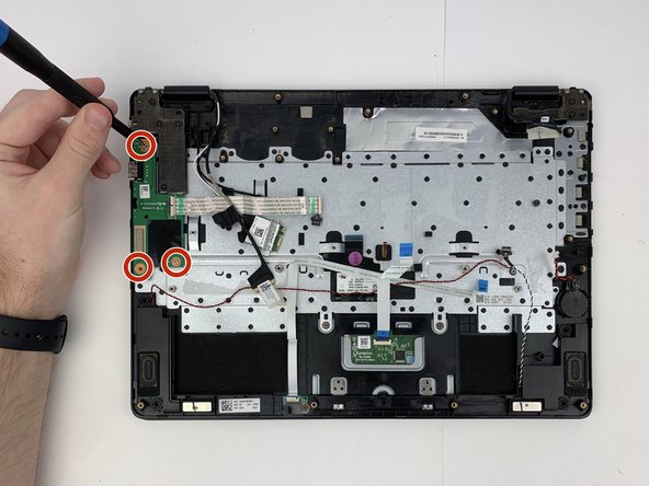

    • Remove the motherboard and the fan by gently pulling them out of the assembly.
    • Using the Phillips #0 screwdriver, remove the three 3 mm screws holding down the daughterboard and gently pull it up and out of the assembly.

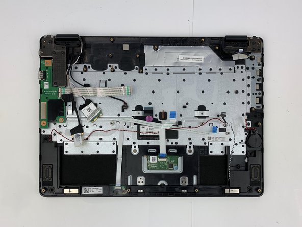

  9. Acer Aspire R R5-471T-51UN Trackpad Replacement: crwdns2935265:09crwdnd2935265:01crwdnd2935265:03crwdne2935265:0 Acer Aspire R R5-471T-51UN Trackpad Replacement: crwdns2935265:09crwdnd2935265:02crwdnd2935265:03crwdne2935265:0 Acer Aspire R R5-471T-51UN Trackpad Replacement: crwdns2935265:09crwdnd2935265:03crwdnd2935265:03crwdne2935265:0

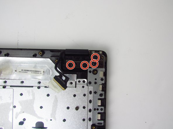

    • Using the Phillips #0 screwdriver, remove the eight 5 mm screws from the display brackets on either side.
  10. Acer Aspire R R5-471T-51UN Trackpad Replacement: crwdns2935265:010crwdnd2935265:01crwdnd2935265:02crwdne2935265:0 Acer Aspire R R5-471T-51UN Trackpad Replacement: crwdns2935265:010crwdnd2935265:02crwdnd2935265:02crwdne2935265:0

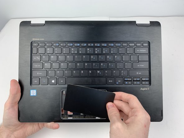

    • Remove the keyboard assembly by gently pulling it up.

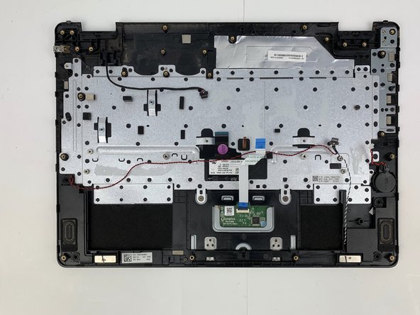

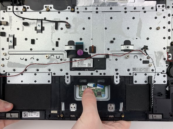

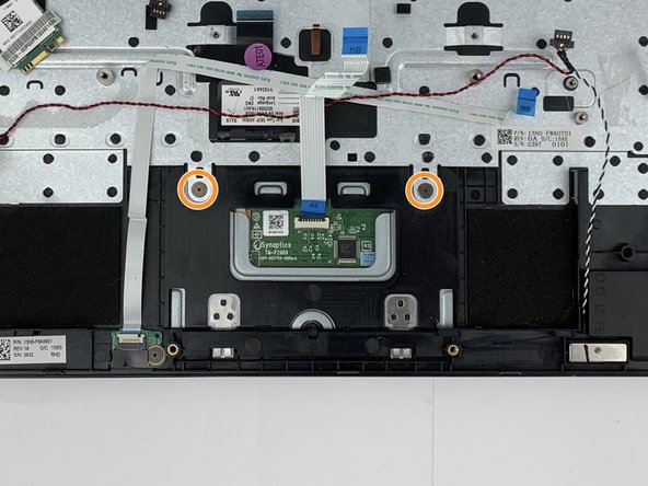

  11. Acer Aspire R R5-471T-51UN Trackpad Replacement, Trackpad: crwdns2935265:011crwdnd2935265:01crwdnd2935265:02crwdne2935265:0 Acer Aspire R R5-471T-51UN Trackpad Replacement, Trackpad: crwdns2935265:011crwdnd2935265:02crwdnd2935265:02crwdne2935265:0
    • Use a spudger to flip up the locking tab of the trackpad ZIF connector and remove the ribbon cable from it.
    • Remove the two screws holding the trackpad to the frame with a Phillips #0 screwdriver.
  12. Acer Aspire R R5-471T-51UN Trackpad Replacement: crwdns2935265:012crwdnd2935265:01crwdnd2935265:03crwdne2935265:0 Acer Aspire R R5-471T-51UN Trackpad Replacement: crwdns2935265:012crwdnd2935265:02crwdnd2935265:03crwdne2935265:0 Acer Aspire R R5-471T-51UN Trackpad Replacement: crwdns2935265:012crwdnd2935265:03crwdnd2935265:03crwdne2935265:0
    • Gently remove the trackpad from the keyboard assembly by pushing out the trackpad lightly from behind.
