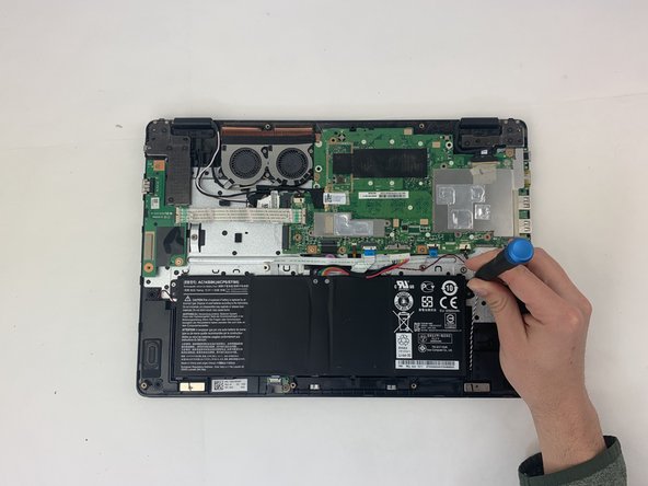

  3. Acer Aspire R R5-471T-51UN SSD Replacement: crwdns2935265:03crwdnd2935265:01crwdnd2935265:02crwdne2935265:0 Acer Aspire R R5-471T-51UN SSD Replacement: crwdns2935265:03crwdnd2935265:02crwdnd2935265:02crwdne2935265:0
    • Use your Phillips #0 screwdriver to remove the two 3mm screws on the battery.
  4. Acer Aspire R R5-471T-51UN SSD Replacement: crwdns2935265:04crwdnd2935265:01crwdnd2935265:03crwdne2935265:0 Acer Aspire R R5-471T-51UN SSD Replacement: crwdns2935265:04crwdnd2935265:02crwdnd2935265:03crwdne2935265:0 Acer Aspire R R5-471T-51UN SSD Replacement: crwdns2935265:04crwdnd2935265:03crwdnd2935265:03crwdne2935265:0
    • Gently and cautiously pinch the white ends of the battery connector cable and slowly pull it from the motherboard.
  5. Acer Aspire R R5-471T-51UN SSD Replacement: crwdns2935265:05crwdnd2935265:01crwdnd2935265:02crwdne2935265:0 Acer Aspire R R5-471T-51UN SSD Replacement: crwdns2935265:05crwdnd2935265:02crwdnd2935265:02crwdne2935265:0
    • Gently lift the battery out of the laptop.
    • Be cautious with the lithium ion battery as you remove it.
