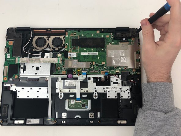

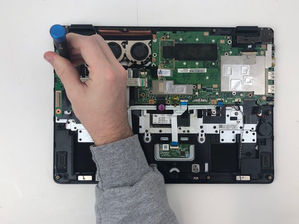

  6. Acer Aspire R R5-471T-51UN Display Assembly Replacement, Display Assembly: crwdns2935265:06crwdnd2935265:01crwdnd2935265:03crwdne2935265:0 Acer Aspire R R5-471T-51UN Display Assembly Replacement, Display Assembly: crwdns2935265:06crwdnd2935265:02crwdnd2935265:03crwdne2935265:0 Acer Aspire R R5-471T-51UN Display Assembly Replacement, Display Assembly: crwdns2935265:06crwdnd2935265:03crwdnd2935265:03crwdne2935265:0
    • Using the Phillips #0 screwdriver, unscrew the eight 5mm screws securing the screen brackets in place.

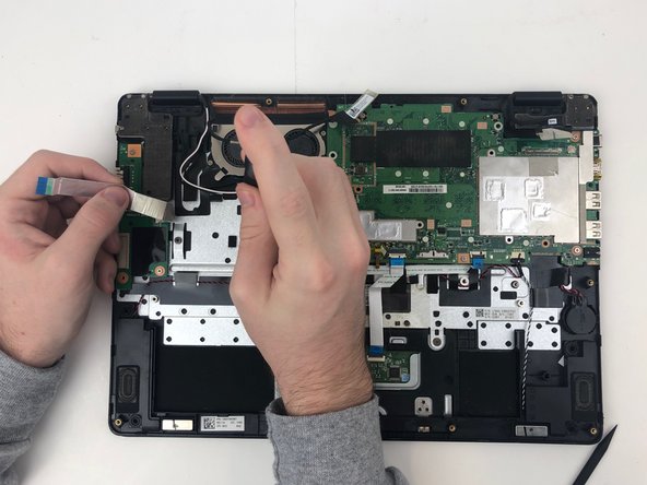

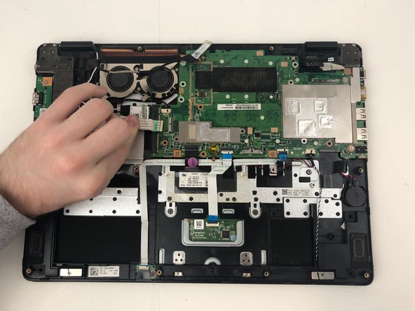

  7. Acer Aspire R R5-471T-51UN Display Assembly Replacement: crwdns2935265:07crwdnd2935265:01crwdnd2935265:03crwdne2935265:0 Acer Aspire R R5-471T-51UN Display Assembly Replacement: crwdns2935265:07crwdnd2935265:02crwdnd2935265:03crwdne2935265:0 Acer Aspire R R5-471T-51UN Display Assembly Replacement: crwdns2935265:07crwdnd2935265:03crwdnd2935265:03crwdne2935265:0
    • Using the spudger, push up the locking tab of the ZIF interconnect cable so that the ribbon cable pops out.
  8. Acer Aspire R R5-471T-51UN Display Assembly Replacement: crwdns2935265:08crwdnd2935265:01crwdnd2935265:02crwdne2935265:0 Acer Aspire R R5-471T-51UN Display Assembly Replacement: crwdns2935265:08crwdnd2935265:02crwdnd2935265:02crwdne2935265:0
    • Disconnect the coaxial cables on the Wi-Fi card by pinching the ends of the cables and slowly pulling them out.
    • Using the Phillips #0 screwdriver, unscrew the 3mm screw holding the Wi-Fi card in place and take out the card.

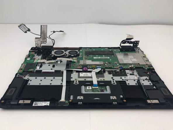

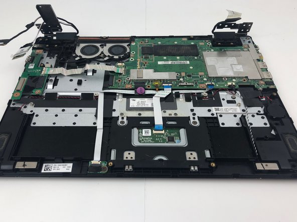

    • Pry up the display brackets so they are clear of the motherboard and case.
  9. Acer Aspire R R5-471T-51UN Display Assembly Replacement: crwdns2935265:09crwdnd2935265:01crwdnd2935265:03crwdne2935265:0 Acer Aspire R R5-471T-51UN Display Assembly Replacement: crwdns2935265:09crwdnd2935265:02crwdnd2935265:03crwdne2935265:0 Acer Aspire R R5-471T-51UN Display Assembly Replacement: crwdns2935265:09crwdnd2935265:03crwdnd2935265:03crwdne2935265:0
    • Gently pull off the display assembly so that it comes apart from the rest of the laptop.
