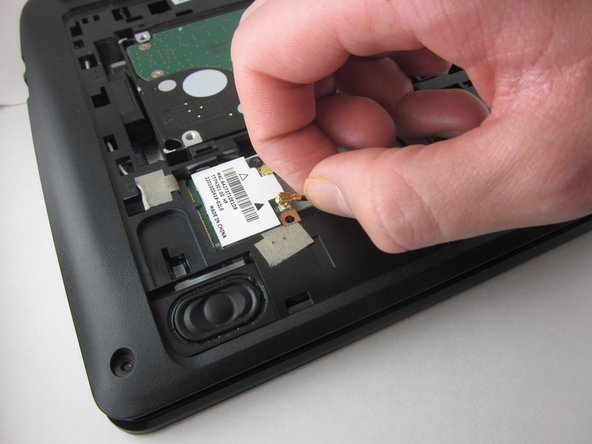

  4. Acer Aspire One P1VE6 WLAN Card Replacement: crwdns2935265:04crwdnd2935265:01crwdnd2935265:02crwdne2935265:0 Acer Aspire One P1VE6 WLAN Card Replacement: crwdns2935265:04crwdnd2935265:02crwdnd2935265:02crwdne2935265:0
    • Unplug the white and black cables connecting the WLAN card.
  5. Acer Aspire One P1VE6 WLAN Card Replacement: crwdns2935265:05crwdnd2935265:01crwdnd2935265:01crwdne2935265:0
    • Remove the 4mm Phillips #1 screw holding the WLAN card holding it in place.

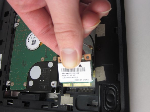

  6. Acer Aspire One P1VE6 WLAN Card Replacement: crwdns2935265:06crwdnd2935265:01crwdnd2935265:02crwdne2935265:0 Acer Aspire One P1VE6 WLAN Card Replacement: crwdns2935265:06crwdnd2935265:02crwdnd2935265:02crwdne2935265:0
    • Unplug the card.
