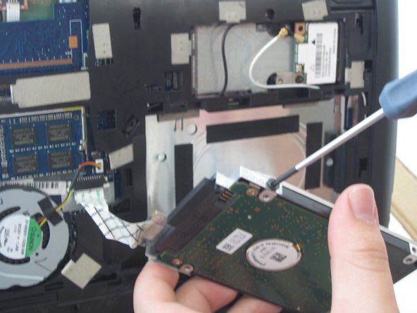

  5. Acer Aspire One P1VE6 Hard Drive Replacement: crwdns2935265:05crwdnd2935265:01crwdnd2935265:02crwdne2935265:0 Acer Aspire One P1VE6 Hard Drive Replacement: crwdns2935265:05crwdnd2935265:02crwdnd2935265:02crwdne2935265:0
    • Locate the two 4 mm Philips #1 screws holding the hard drive into its bracket.
    • Remove the two screws and place them somewhere they will not be lost.
  6. Acer Aspire One P1VE6 Hard Drive Replacement: crwdns2935265:06crwdnd2935265:01crwdnd2935265:02crwdne2935265:0 Acer Aspire One P1VE6 Hard Drive Replacement: crwdns2935265:06crwdnd2935265:02crwdnd2935265:02crwdne2935265:0
    • Unplug the hard drive from the bracket.
