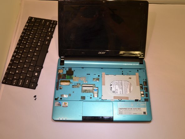

    • Carefully insert the blue plastic opening tool between the F8 key and the blue plastic covering.
    • Try not to damage the F8 key.
    • After insertion, carefully slide the tool popping the keyboard out.
    • The keyboard is still attached to the blue casing by a ribbon cable.
    • On the bottom of the keyboard, gently pull the ribbon cable out of the cable holder.

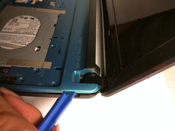

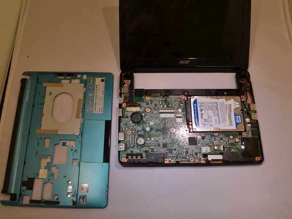

  4. Acer Aspire One D270-1865 Screen Replacement: crwdns2935265:04crwdnd2935265:01crwdnd2935265:03crwdne2935265:0 Acer Aspire One D270-1865 Screen Replacement: crwdns2935265:04crwdnd2935265:02crwdnd2935265:03crwdne2935265:0 Acer Aspire One D270-1865 Screen Replacement: crwdns2935265:04crwdnd2935265:03crwdnd2935265:03crwdne2935265:0
    • Using a Phillips #00 screwdriver, remove each screw:
    • Eleven 2mm Phillips #00 screws
    • Three 2mm Phillips #00 screws
    • Using the opening tool, gently insert it into the crack of the blue casing and the bottom of the laptop.
    • Begin separating the two until the blue casing is fully off.

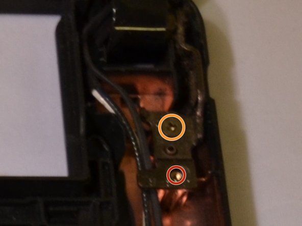

    • Using a Phillips #00 screwdriver, remove the screws on the hinges holding the laptop screen and the keyboard together:
    • One 2mm Phillips #00 screws

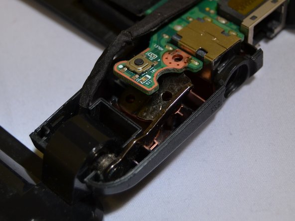

    • On the left hinge, gently lift up the motherboard and carefully pull out the hinge.

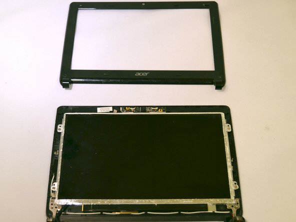

  7. Acer Aspire One D270-1865 Screen Replacement: crwdns2935265:07crwdnd2935265:01crwdnd2935265:02crwdne2935265:0 Acer Aspire One D270-1865 Screen Replacement: crwdns2935265:07crwdnd2935265:02crwdnd2935265:02crwdne2935265:0
    • Insert the opening tool between the screen casing and the back casing.
    • Begin separation until the casing and the back is fully separated.

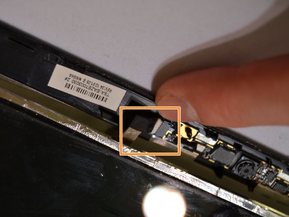

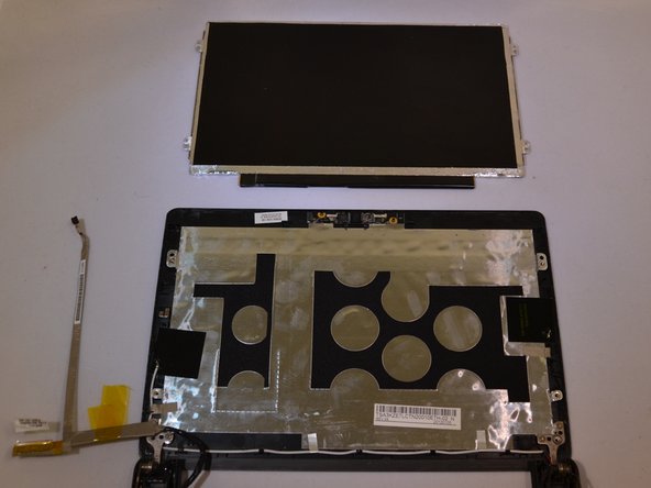

    • Remove the four 2mm Phillips #00 screws holding the screen in place.
    • Gently lift the screen up while holding down the cable cord at the top of the screen.
    • Gently remove the cable cord from its outlet.

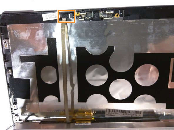

  9. Acer Aspire One D270-1865 Screen Replacement: crwdns2935265:09crwdnd2935265:01crwdnd2935265:03crwdne2935265:0 Acer Aspire One D270-1865 Screen Replacement: crwdns2935265:09crwdnd2935265:02crwdnd2935265:03crwdne2935265:0 Acer Aspire One D270-1865 Screen Replacement: crwdns2935265:09crwdnd2935265:03crwdnd2935265:03crwdne2935265:0

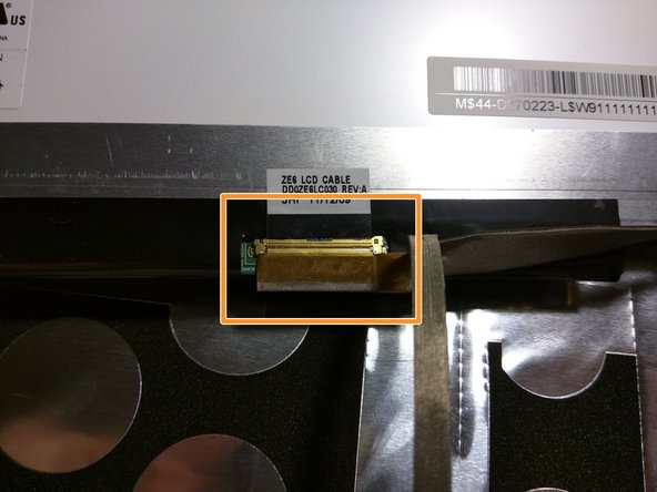

    • Remove the yellow sticky tape at the bottom of the screen.
    • Gently pull the cable at the bottom of the screen, detaching all wires and the tape from screen.
    • Remove the screen.
