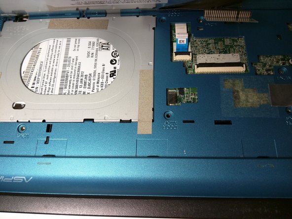

  2. Acer Aspire One D270-1865 Keyboard Replacement, Keyboard: crwdns2935265:02crwdnd2935265:01crwdnd2935265:02crwdne2935265:0 Acer Aspire One D270-1865 Keyboard Replacement, Keyboard: crwdns2935265:02crwdnd2935265:02crwdnd2935265:02crwdne2935265:0
    • Flip the device right-side up.
    • Open device.
    • Insert the plastic opening tool above the F8 key.
    • Do not damage the F8 key.
    • Gently pop off the keyboard by pulling up and towards you.
  3. Acer Aspire One D270-1865 Keyboard Replacement: crwdns2935265:03crwdnd2935265:01crwdnd2935265:02crwdne2935265:0 Acer Aspire One D270-1865 Keyboard Replacement: crwdns2935265:03crwdnd2935265:02crwdnd2935265:02crwdne2935265:0
    • Remove the keyboard ribbon attached to the bottom of the keyboard by pulling it forward.
    • Remove the keyboard.
