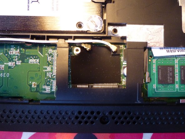

  8. Acer Aspire One D257 Wireless card Replacement, Wireless card: crwdns2935265:08crwdnd2935265:01crwdnd2935265:01crwdne2935265:0
    • Turn around the netbook so we look on the bottom.
  9. Acer Aspire One D257 Wireless card Replacement: crwdns2935265:09crwdnd2935265:01crwdnd2935265:03crwdne2935265:0 Acer Aspire One D257 Wireless card Replacement: crwdns2935265:09crwdnd2935265:02crwdnd2935265:03crwdne2935265:0 Acer Aspire One D257 Wireless card Replacement: crwdns2935265:09crwdnd2935265:03crwdnd2935265:03crwdne2935265:0
    • With an anti static spudger carfully remove the antenna cables from the connection on the WiFi-card.
    • Remove the screw to then lift the card from the socket.
    • Now you can install a new or better WiFi-card. I have installed a Dualband AC card from Intel into my netbook, the AC 7260.
