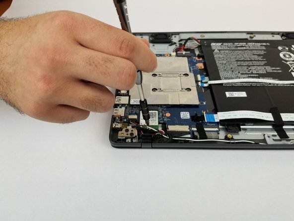

    • Remove the ten 7mm Phillips #0 screws from the bottom.
  2. Acer Aspire One Cloudbook 14 AO1-431-C8G8 Wifi Card Replacement: crwdns2935265:02crwdnd2935265:01crwdnd2935265:02crwdne2935265:0 Acer Aspire One Cloudbook 14 AO1-431-C8G8 Wifi Card Replacement: crwdns2935265:02crwdnd2935265:02crwdnd2935265:02crwdne2935265:0
    • Insert a plastic opening tool under the bottom cover and slid it around the perimeter until all of the clips release.
  3. Acer Aspire One Cloudbook 14 AO1-431-C8G8 Wifi Card Replacement, Wifi Card: crwdns2935265:03crwdnd2935265:01crwdnd2935265:02crwdne2935265:0 Acer Aspire One Cloudbook 14 AO1-431-C8G8 Wifi Card Replacement, Wifi Card: crwdns2935265:03crwdnd2935265:02crwdnd2935265:02crwdne2935265:0
    • Disconnect the two antenna cables from the Wi-Fi card.
  4. Acer Aspire One Cloudbook 14 AO1-431-C8G8 Wifi Card Replacement: crwdns2935265:04crwdnd2935265:01crwdnd2935265:02crwdne2935265:0 Acer Aspire One Cloudbook 14 AO1-431-C8G8 Wifi Card Replacement: crwdns2935265:04crwdnd2935265:02crwdnd2935265:02crwdne2935265:0
    • Remove the single 5mm Phillips #0 screw from the Wi-Fi card.
  5. Acer Aspire One Cloudbook 14 AO1-431-C8G8 Wifi Card Replacement: crwdns2935265:05crwdnd2935265:01crwdnd2935265:02crwdne2935265:0 Acer Aspire One Cloudbook 14 AO1-431-C8G8 Wifi Card Replacement: crwdns2935265:05crwdnd2935265:02crwdnd2935265:02crwdne2935265:0
    • Slide out the Wifi card from its slot by pulling parallel to the board.
